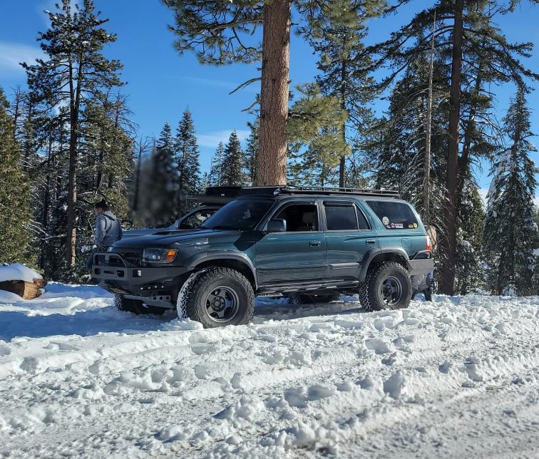

This is how it sits at that weight on the trip. Tires are 235/85-16s. Front is probably a little low, it's just the stock 600lbs Icon springs at stock 3" lift (unloaded), but I have a bumper, winch, full skids, and dual batteries up front. Unfortunately I didn't take any measurements.
