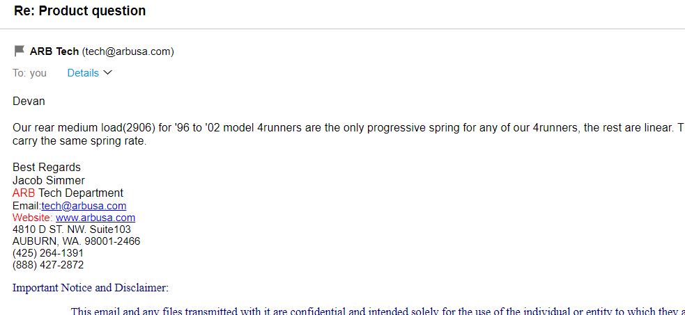

Regarding the discussion initially, I asked ARB what coils they had were progressive rate and this was their response. Thought it seemed funky; that this was the first time I was hearing they offered multiple kinds. (other half of the email was a separate question)

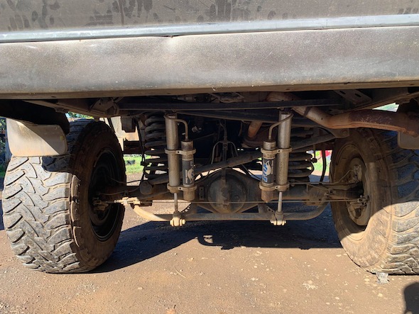

ever seen a rear like this?
just bought this 2000 and im not familiar with this rear end, anyone seen this before? springs are from a older f250 i believe. truck is sitting around 6-7 inch lift with no spacers. rear end vibrates after 40mph. please help lol
Yikes, okay...
This is definitely a one off job, not something you'd buy off the shelf. Looks like they made custom top and bottom shock mounts. Guessing those shocks aren't from a 3rd gen 4Runner either.
Does the 6-7" lift include a body lift? If not, something with running this much suspension lift is most likely the root of your problem.
How many miles are on the 4Runner? Know if the U-Joints have ever been replaced? Stock driveshaft?
Edit: After looking at the angle on that panhard bar, I'm guessing it's all suspension lift?

You are looking a custom-hack job. Nothing there is correct. The springs are WAAAy too thick to actually be from a Toyota, the panhard bar is at a 45 degree angle, and the shocks mount to the front in the stock configuration. You are going to have to find a custom 4x4 shop to get this sorted. Good luck bro. I imagine those cheap ass, super wide tires are contributing to your vibration.

Who knows if this is a hack job. Can you see the quality of the welds or anything else?
He stated the coils are from a Ford and not a Toyota. Nice job reading there.
Those tires are Toyo Open Country M/Ts, not a cheap ass tire. Nice job on the assumption.

Yeah its all suspension, its got 160k miles and u joints have been done but not the driveshaft
What's the front end look like?
Lol yeah if only it was the tires, it only vibrates in the rear so im assuming it has something to do with the way this “custom” job. Front end is a 6” fabtech w dirt logic 2.0 coilovers and camburg ucas
Generally speaking, when folks do that much lift they rotate the axle to point the pinion at the tranny and then run a double cardan or something to reduce driveline U-joint angle.
Also might be that your driveline U-joints aren’t clocked properly.
I don’t get the lower drag bar they put on for the lower shock mounts. Looks like a pavement pounder lift.
The bump stops look original....
I love the brake line mount relocation.
yeah honestly this whole rear end is just a head scratcher. lol
