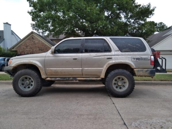

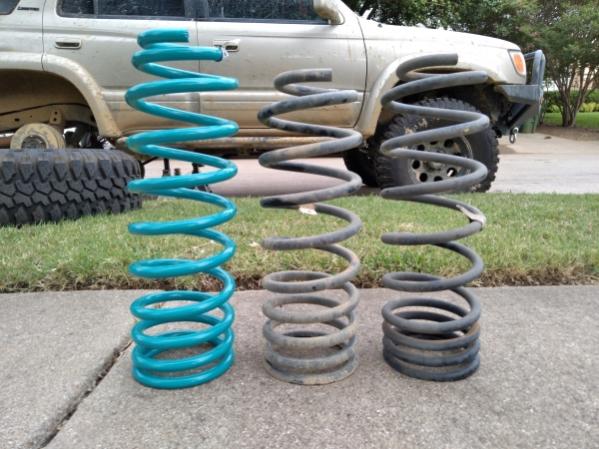

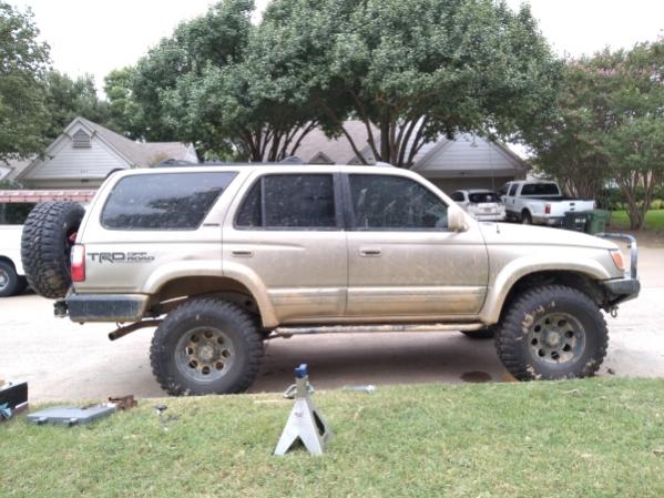

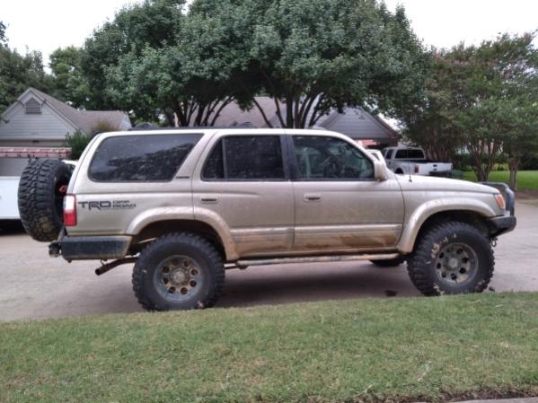

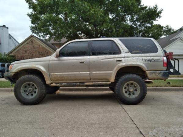

Hey! Long time listener, first time caller. I installed the Dobinsons 210v coils this morning and I have pics! I have a 2002 limited and have had OME 890 and 891 coils before today. My suspension in front is the tundra TRD/Bilstein 5100 setup on the bottom perch. Rear has been Bilstein 5100's with 891 coils and 890's before that, both with the yellow 10mm trim pieces.
Front hub to fender is right at 22" both sides and the right rear sat about 22.25" and the left rear was 22.5" with the 891's.
After installing the Dobinsons without the 10mm trim pieces, the new measurements are 24 right rear and 24.5 left rear with half a tank of gas.

The left side looks higher because of the street grade and the angle from which the photo was taken. After a week or so I'll measure again to see if the coils have settled at all. The box the Dobinsons came in said to drive 1km and measure again; that, I did not do. I'll be getting new shocks and bumpstops this week, too.
