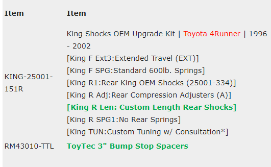

The King OEM upgrade with extra travel on the 600 lb springs. My wife and I spent all day yesterday driving around on various roads and I wish I had done this sooner. I am traveling for work this week but hope to get on the trails in a few weeks to check out the travel on the shocks soon.
