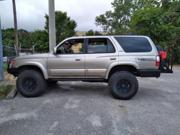

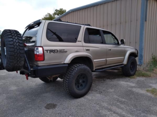

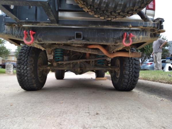

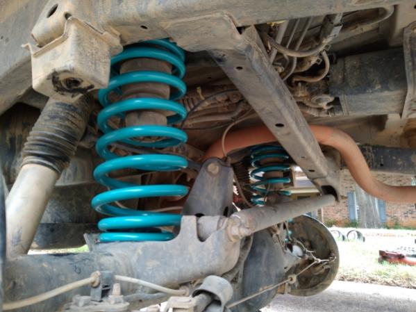

Hey, so it's been a week with the Dobinsons and so far I like them a lot! Now, I am waiting on some Bilstein 33-187174 shocks from 4Wheelparts and bump stops from Sonaoran Steel, so I haven't been off road yet. The shocks have been sitting at a dock in Dallas for over a week and I wish I could just drive over there and pick them up. I should get a call any day now. They feel a bit like the 891 coils if not slightly stiffer and seem to handle my bumper, spare, hi-lift, jerry can and recovery gear (maybe around 330 lbs.) even better! I run without the stabilizer bar and with the extra 2 inches of lift there is slightly more body roll when turning. With the 891's and the 10mm trim pieces it was at 22.5". With the 210v's and no 10mm trim pieces it's at 24.5". both with the internal cone bump stops. The blue looks great, too!

What were your coils/shocks up front again? Looks pretty good, might just shoot for these if they don't offer something closer to 3in, it's a little more rake than I like but this is becoming a headache
Edit: nevermind, just saw it's TRD/Tundra 5100. Keep us posted :)

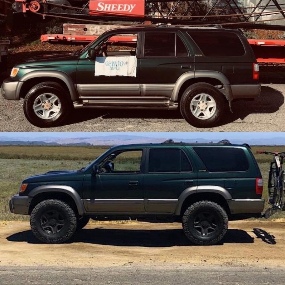

I'm more on the budget/superficial end of the spectrum. I did find a pic of my 2000 they day I bought it a few months ago and made a little before/after collage. It's not as golfer-dude-looking (to me) as it was, at least, and a lot more confidence-inspiring on the trail. Still a lot of stuff I'd like to do, but juggling time/money/fam etc....
