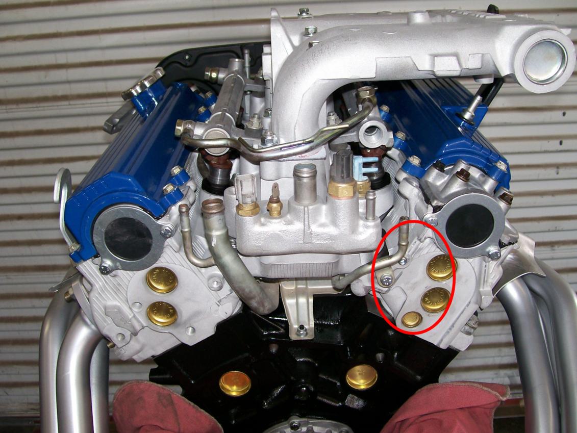

I've already bypassed the heater core... its coming from closer to the passenger side firewall... I attached a pic from where I think the leak is coming from (hopefully I attached it correctly).

i've re-sealed with RTV and new gasket, the coolant bypass block behind the engine under the intake, i've RTV one side of the U shaped hose that goes into it. i'm looking all around that area, but i don't know if there is another coolant line i'm missing... i don't think its the hardline that runs through the center of the block just under that intake. the leak is coming from somewhere right behind the bypass block, or just to the left of it, on the passenger side. maybe its the other end of the U shaped hose...??? i did notice it buldging but i didn't see any wetness coming from that area, so i'm not sure. i'm going to take the other end of the U shaped hose off and use RTV and heat shrink hosing around it and try to seal it better, maybe that'll do it. it'll at least eliminate the coolant bypass block completely...
found the leaking... the hoses that attach to the coolant bypass block behind the engine underneath the intake plenum are leaking, everytime i fix one leak another springs up...lol but i think i'll have the issues completely fixed tomorrow. i've used RTV inside each hose and on the actually metal piping that comes out to seal the leaking... and of course tightend the C-clamps (not to tightly of course). i'll be going on to the final hose tomorrow and hopefully stop this leaking nonsense...

which tube/hose are you talking about? there is a coolant bypass block on the back of our engines where 2 or 3 hoses go to. its a PITA to get to though.
cameron, if you're talking about the metal coolant tubes that run just under the upper manifold, i believe they are a dealer item... however, if you go to your local pull a part, you might be able to score one. i've heard and read that those things go bad easy if water has been used... let me know if you have any questions or concerns.
