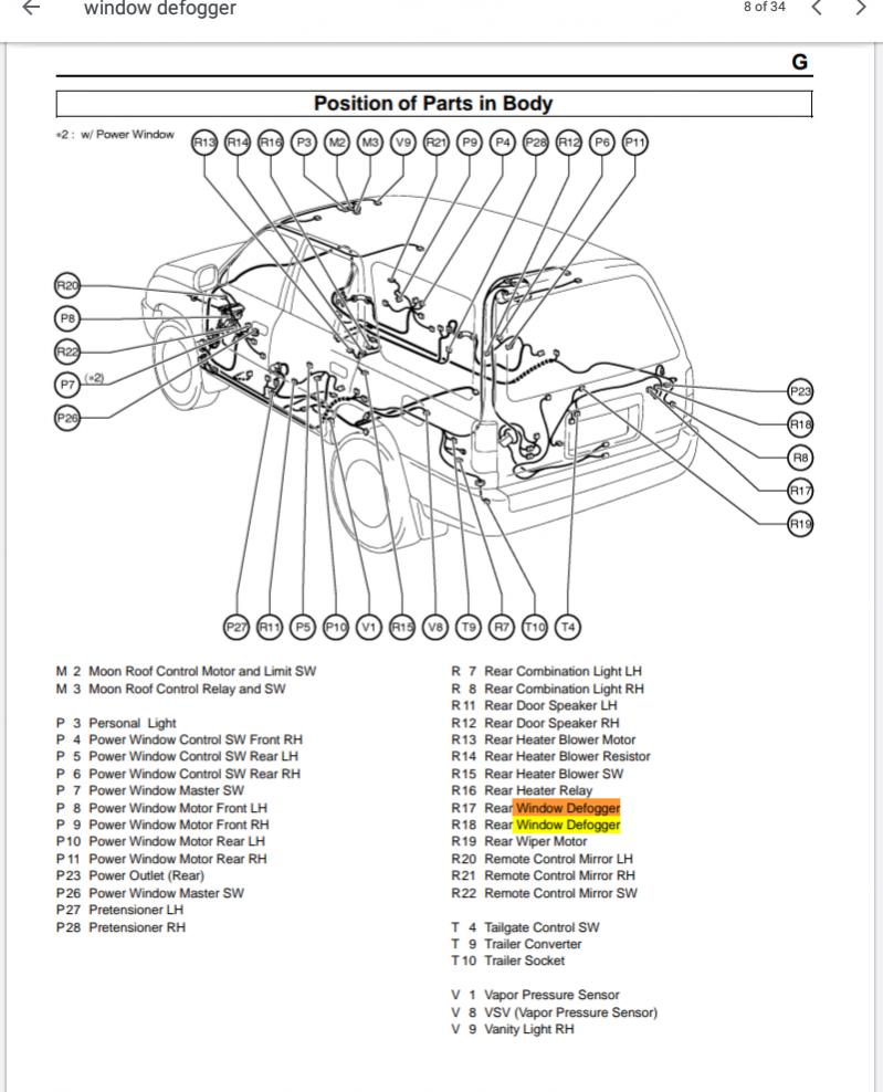

rear defogger wire location

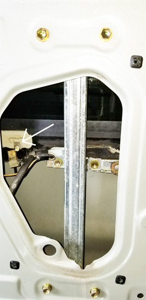

Connection for defrost on the passenger side of rear window.
Ok!! So went in and removed the plastic cover and the inner metal cover. Unplugged both plugs and.......it appears I have less noise coming into the radio!!! I have to drive around and see how it sounds around the noisy areas of town.
