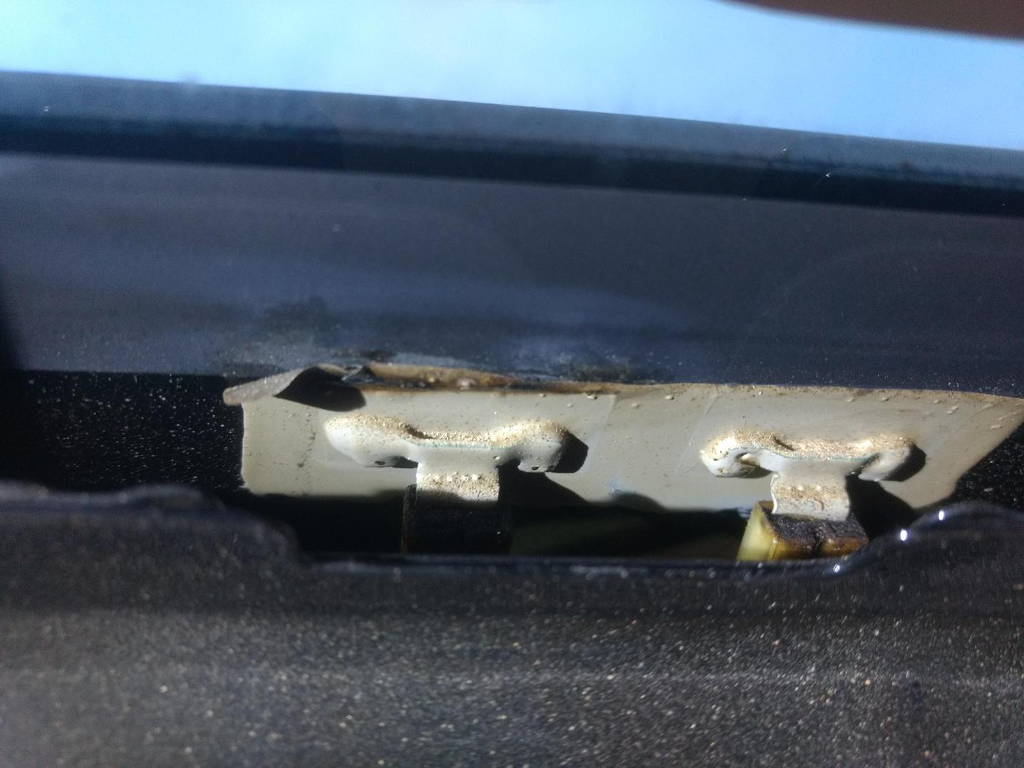

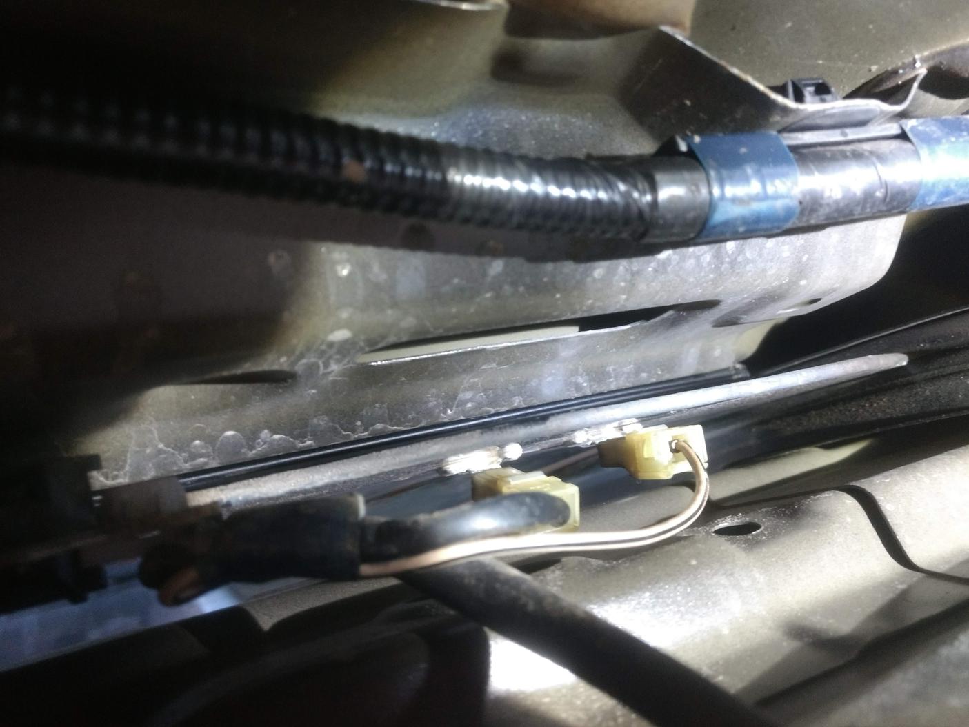

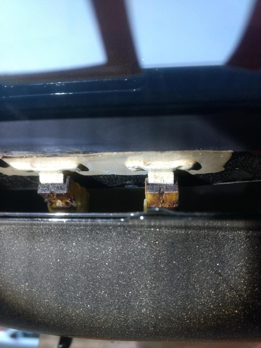

Update: I pulled the panel off the back gate and tried to find the connection for the defrost. I assume it's these 2 connectors on the bottom right of the window (these pics are seen from inside the panel). They look kind of burned out on the top. Could this be the issue? If so, how can I fix it?

Before I had a chance to do any of what you suggested, the back window spontaneously exploded on me while driving to work this morning. I didn't even have the defrost on at the time (I had turned it on for maybe 5 minutes at the start of my drive to clear the side mirrors).
Took it to my glass guy who happened to be nearby & he replaced it for $180. Up/down & wipers work fine, but haven't tried the defrost yet because I'm frankly scared to now. Found the Toyota service bulletin that stated that they were aware of this problem and were extending the warranty - until April 30th of this past year. I might still call and see if they will reimburse me anyway.
And so life goes on...
Sorry to hear this, I wouldn't worry about using the defroster it should be fine now, the reason the old glass shatter and why Toyota was replacing them was the connector tabs getting hot and unevenly heating the glass, this it seems was caused by a poor design of the tabs.
