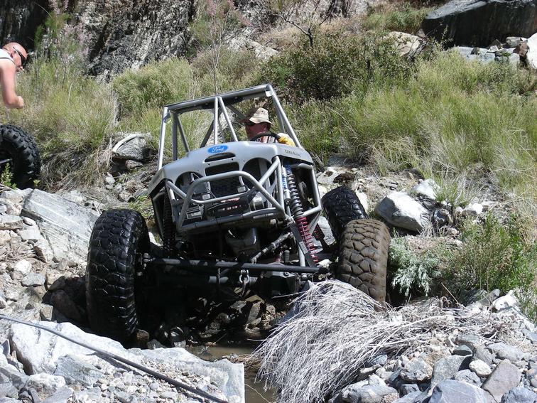

I just used the bellows style. No hoses to mess with, or gear oil smell in the cab.
Care to expand on this? How does the bellows style work? Could you share a pic of what it looks like on your rig?
You take the factory breather out of the axle housing and replace it with the barbed brass fitting, put the bellows on the barbed fitting and use the hose clamp. The system is now sealed against water, but as the housing heats and cools the bellows expands or contracts to accommodate the change in PSI.
Here's one installed on the Dana 60 of my old buggy.
Got it and I guess I should have been able to figure that out on my own. I like this idea. But, I wonder how much pressure can build up in the differential and if the bellow can handle it. What if you go on a very long drive? Will that thing continue to expand until it pops like a balloon?

They use them on Ultra 4 cars in racing conditions. You might be over/under thinking this. :cheers:
