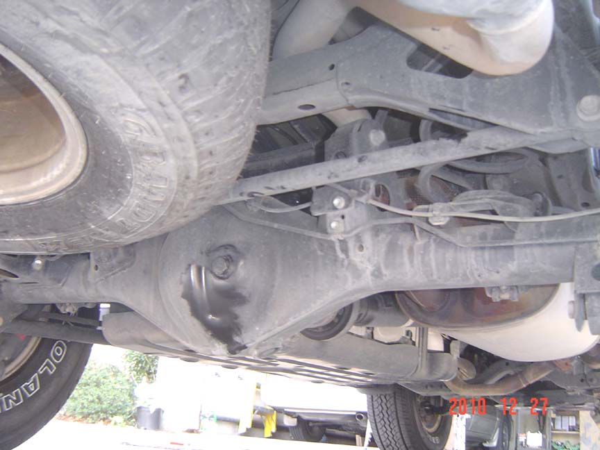

The Trick is the 6-point socket, 18” break over bar and good slow square pressure on the soft shallow bolt ‘s head or it will round very easy. With the spare removed, giving you plenty working room. If it rounds, my guess would be to file 2 opposite sides flat and try vise grips. Why get to the harder options if you can avoid the matter? Hopefully the replacement bolt’s heads are harder and thicker.
Makes me appreciate my Acura RL where I just recently worked 7 of these loose. Transmission,2 on the transfer case, and four in the sh-awd diff.
They have a square recessed indentation that fits a 3/8 inch socket drive. Even so my 3/8" x 20" breaker bar was essential.
