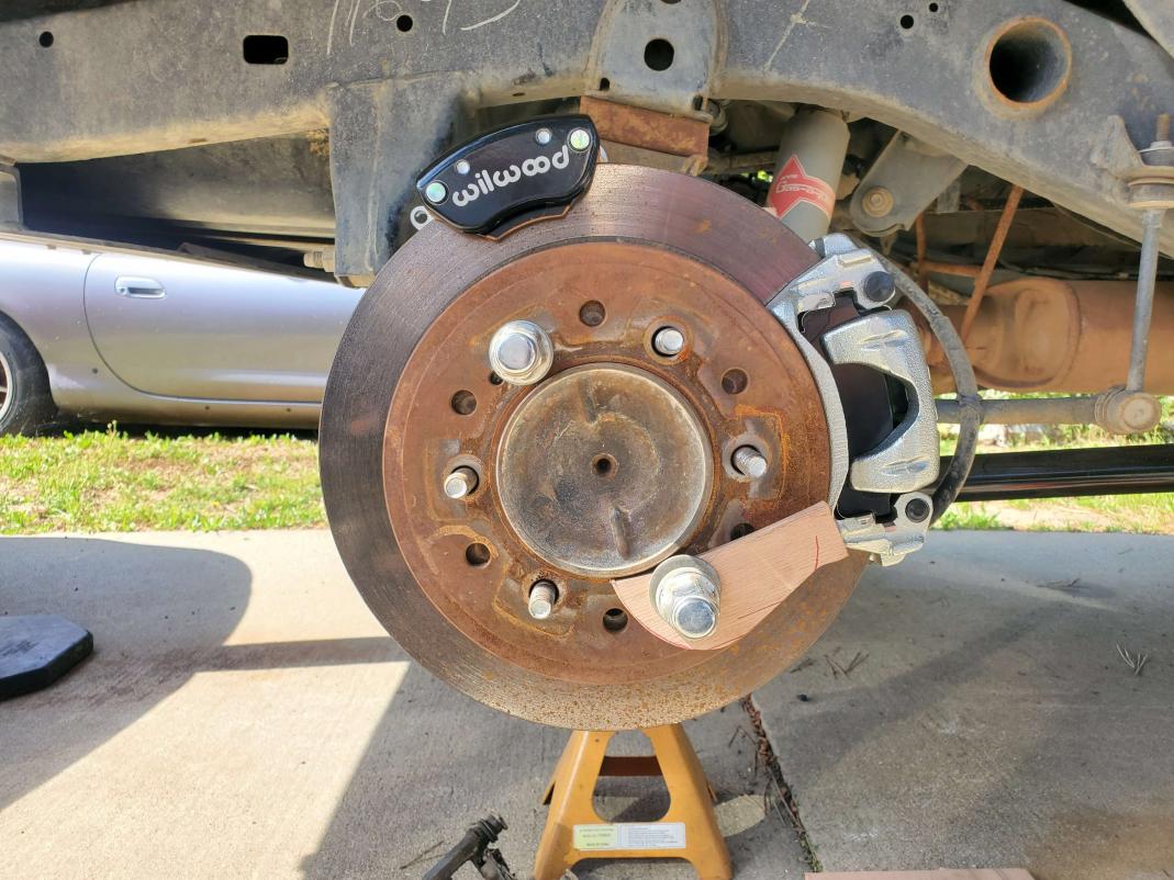

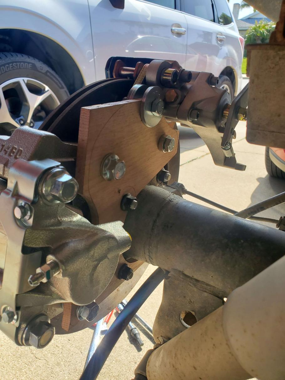

Which is why I'm switching over to the lc80 calipers and wilwood mc4 parking brake caliper. The mustang calipers just are not working for me (between calipers leaking and poor parking brake performance). Everything midcoma made is awesome! Top quality stuff. But it just doesn't work for me so I am working on this now. Don't know if I'll have them reproduced though.
So I might have midcoma's caliper brackets up for sale in a while.
