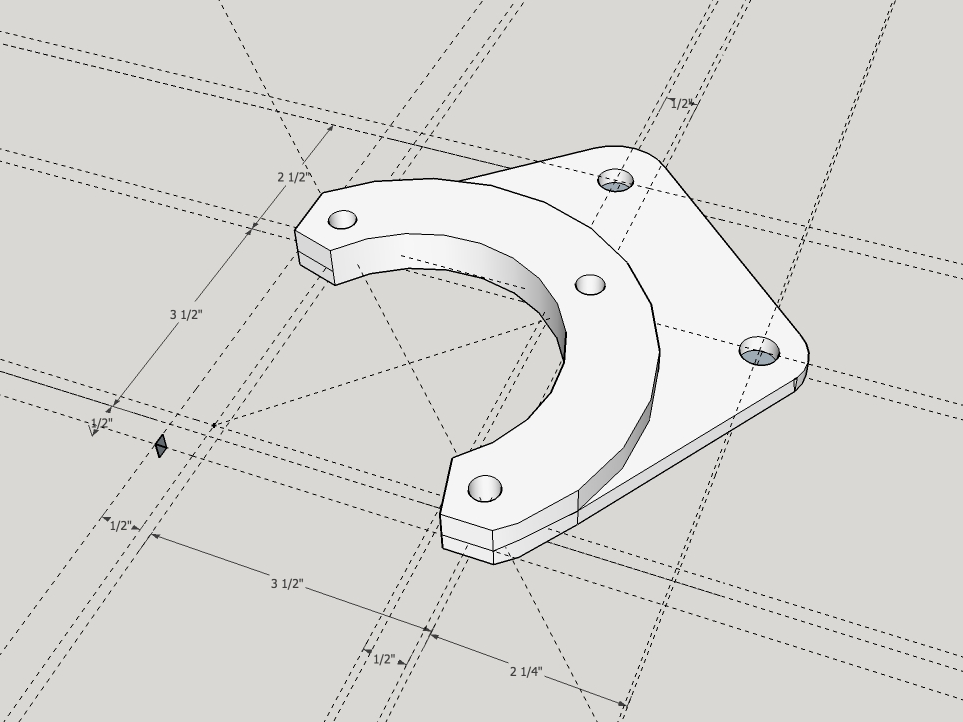

Just playing around with Sketchup I tried modeling a bracket based on what I've seen here in this thread and also what I've seen of a commercial product that trys to do a similar thing. I came up with this. Of course I don't know how thick the stacks of washers are in the set up that is the subject of this thread. I'm estimating 3/8” (0.375”). My prototype here is basically a sandwich of two layers, a 3/8” spacer and the quarter inch mounting plate

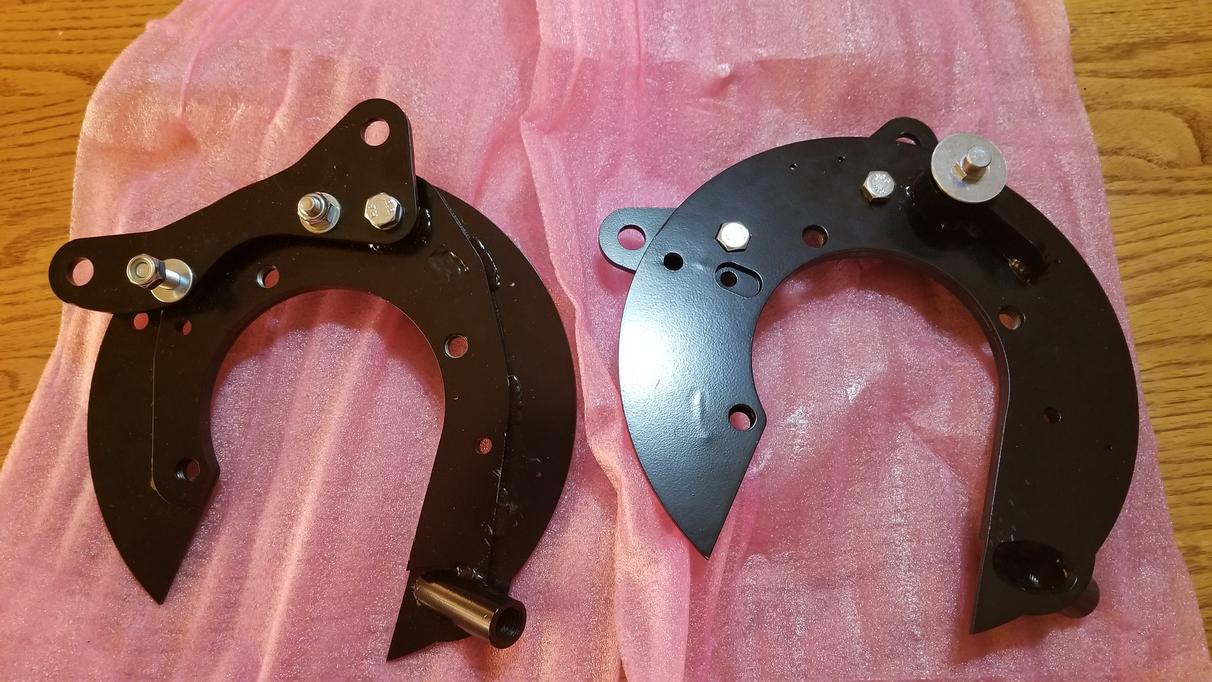

My prototype 3gen 4runner rear disc with ebrake park brake. All Toyota parts expect for the custom bracket. Working with the ebrake line as we talk, 3gen 4runner ebrake brake only used 1 cable. The new setup require 2 cable line (Y) into the hand brake. Quick teaser pic of the bracket, will update as I start to get all my parts in.
Looking forward to seeing what your setup is all about.
