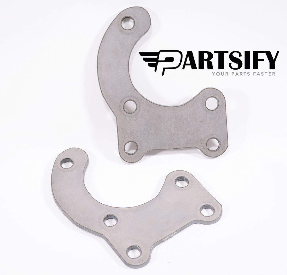

Long time car guy and have always wanted to grab a 3rd gen. Let's just say I don't like the rear drums. I was super surprised to see pretty much no developed kits.
However... I did come across tons of the Gen 1/2 brackets. Is the hub bolt pattern the same on these or not? These things are all over the place and ceap. Hell if even one hole lined up on the hub you could drill the other.
Thoughts?
Thoughts?
As far as bolting to the axle housing the bolt "should" be the same spread and so those should be able to be used. With that said it was pretty easy to build the caliper bracket that I did and posted dimensions here in the thread. It also depends on what caliper those are setup for.
Thoughts?
Biggest issue I see is that the bracket will interfere with the ABS sensor
There's a thread which says the hub bolts patterns are the same between 1-2-3 gens. So hypothetically we can find the right bracket for a 2nd gen and use it on our 3rd gens.
http://www.toyota-4runner.org/3rd-gen-t4rs/162737-gurus-rear-axle-comparison-2-3-gen.html
Good call on the ABS, I could not understand why they never listed 3rd gen as the pattern appeared the same (thanks for confirmation). These use a factory Toyota caliper and would work if you cut off one of the tabs, that said, no e brake.
