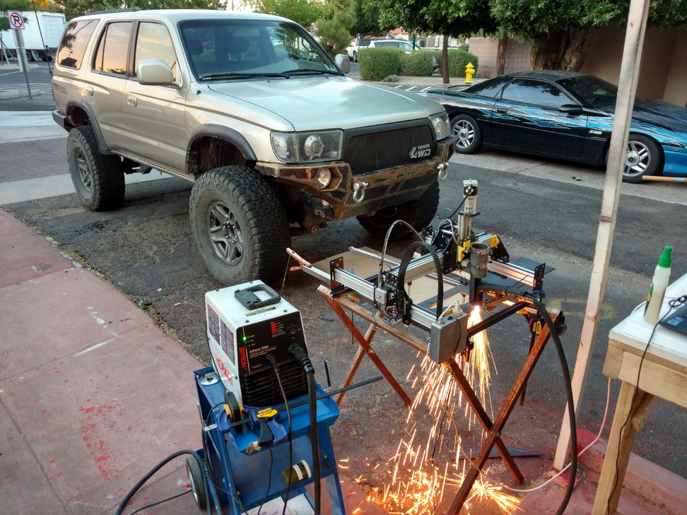

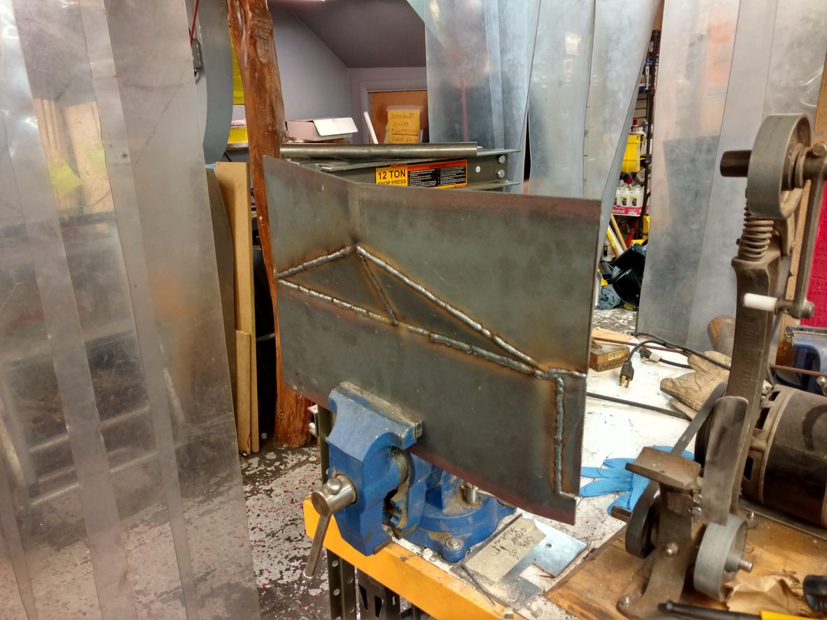

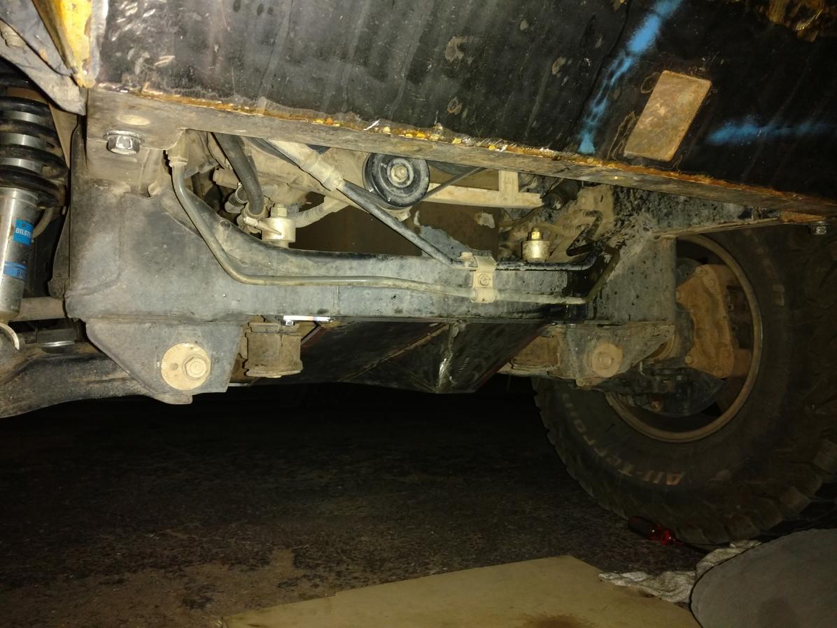

Also got the plasma table clothing today, made a low profile diff skid for the front.
