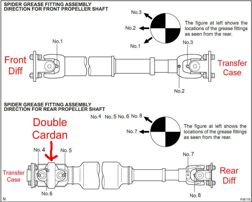

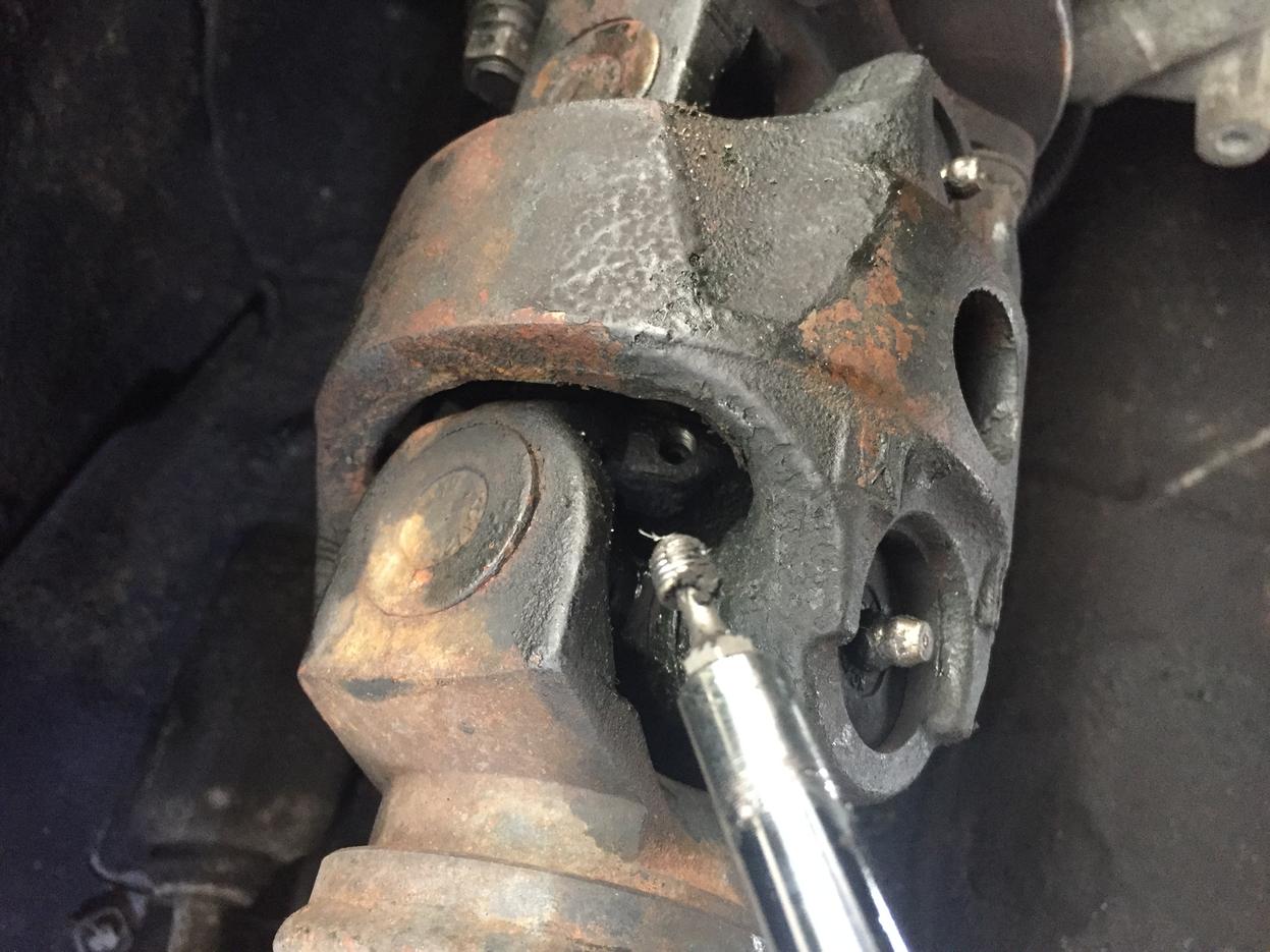

Went to grease my driveshaft and found #6 grease fitting sheared off. I was able to unthread with a T10 Torx bit. My question, has anyone been successful placing a new grease fitting without having to drop the driveshaft? Also, what style fitting is best here...straight or angled...I can't remember what was there before. Thanks!
