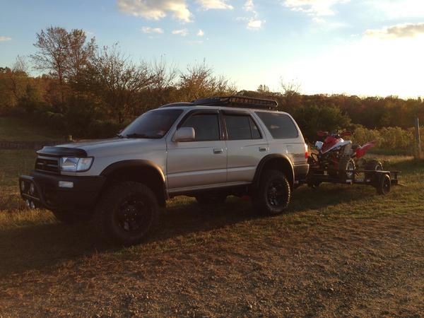

So I tried to search a bit but wasn't sure exactly what terms to use best. Here is my problem. I noticed that my passenger side rear wheel/tire sticks out about 1/2 inch more from the fender flares, then the drivers side. Like the rear end is slightly shifted over. I have a 97 5 speed SR5. I know in my GTO there's a cradle alignment tool used to get things squared away back there, since they would get shipped from Australia with all types of variances in alignment. So is there a way I can get this lined up and adjusted correctly? I'm assuming it would be with the pan hard bar, but is there any adjustment in a stock one?
Adjustable pan hard bar will center it back. Or a pan hard drop bracket if you want to save money.
If you have a lift then your axle will be pushed over to the passenger side. A panhard drop or an adjustable panhard can fix this.

Thanks a lot, yes I have a lift, I will order one today. I looked and I think the Sonoran will do.
