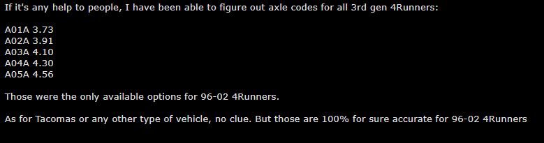

No idea where I got this but I had this in my file of stuff, try this and verify with spin.

This. Supposedly the codes are unreliable. Do the spin test to be sure. It'll take you 10 minutes, and potentially save you a lot of grief and cash
