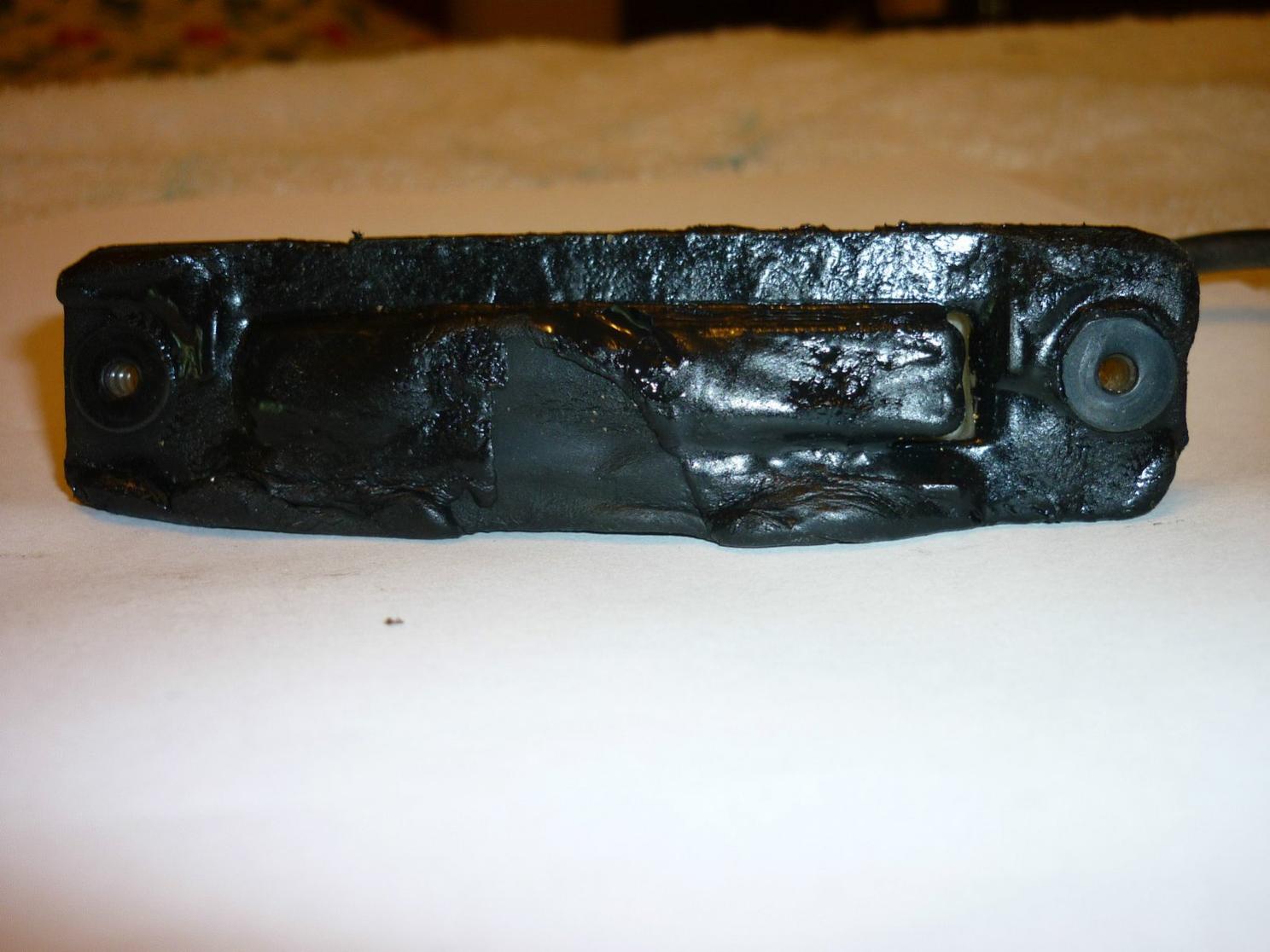

Rear hatch opener melted!

I replaced mine over the summer since mine totally melted looked like stringy bubble gum. You can tell the new part is made of a different material than the old one.

Mine melted. Fingers turn black every time I open the back door. Instead of replacing the rig, thinking of putting a new piece of rubber over the existing goo. Besides, a new Toyota rubber latch will melt again and I'll be back to square one.
The new piece seems to be made of a different material. I don't know of anyone who has replaced it and had it melt again. I replaced mine over a year ago and it's still intact.

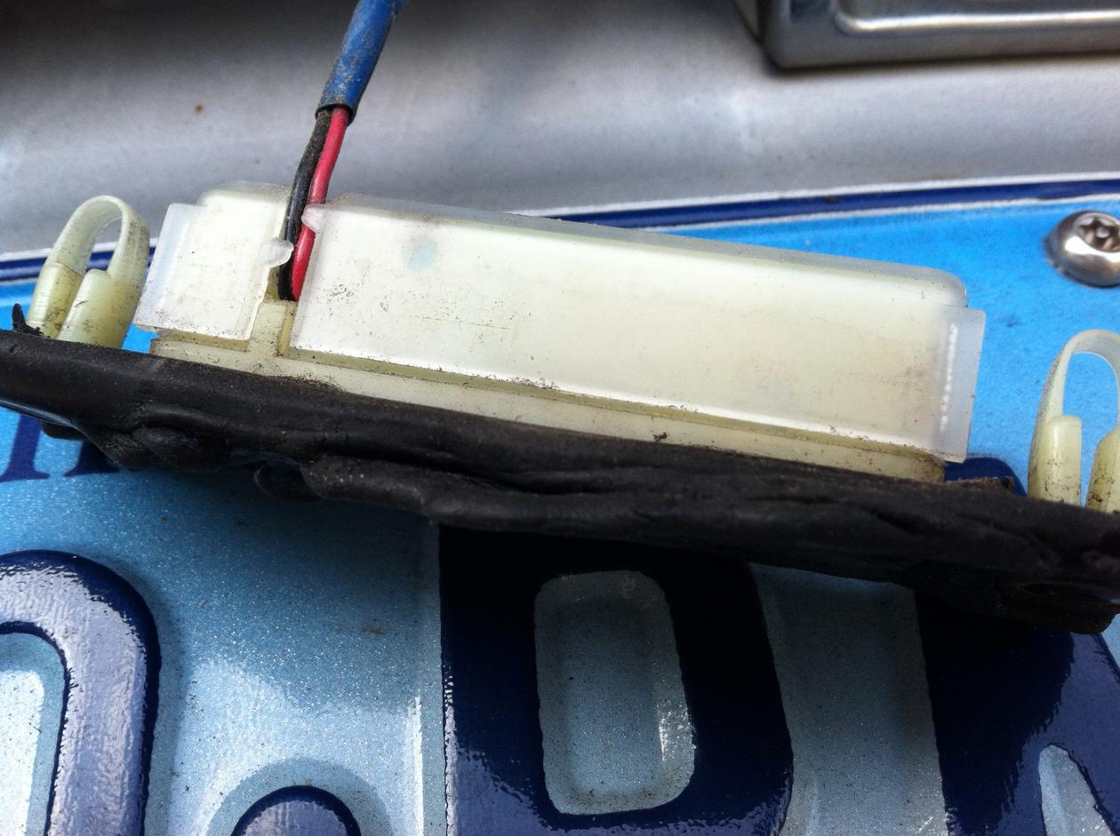

I have a 2008 Toyota Sienna with the same problem for a year. Read that the new swich is made of the same YUKKY material. Actually it is a black rubber sleeve and the Stealerships do not sell that just by itself. as it would have been too simple and they would have to sell it for about $5 instead of getting the vehicle in for servce. I owe credit to this IDEA to another Toyota blogger. It takes about 20 minutes and you do not have to change the whole switch.

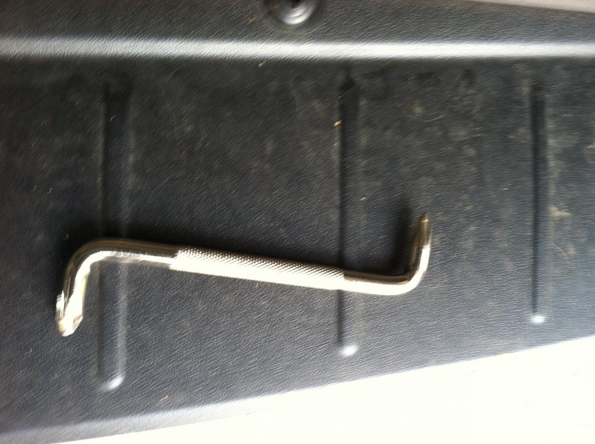

I used a L shaped screw driver as there is not much due to the angle the screw is in. Once the screws are out you can pull the switch out.

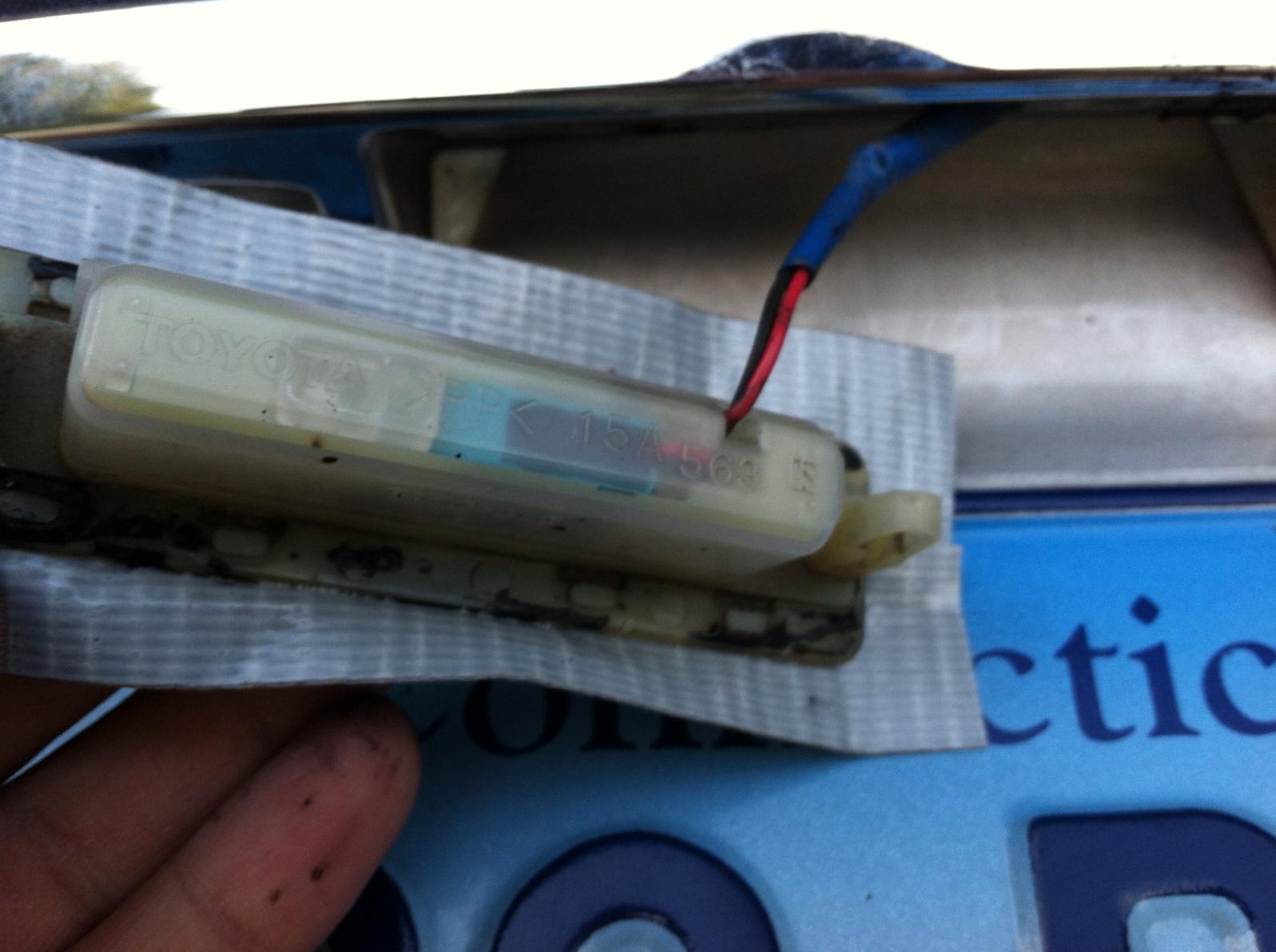

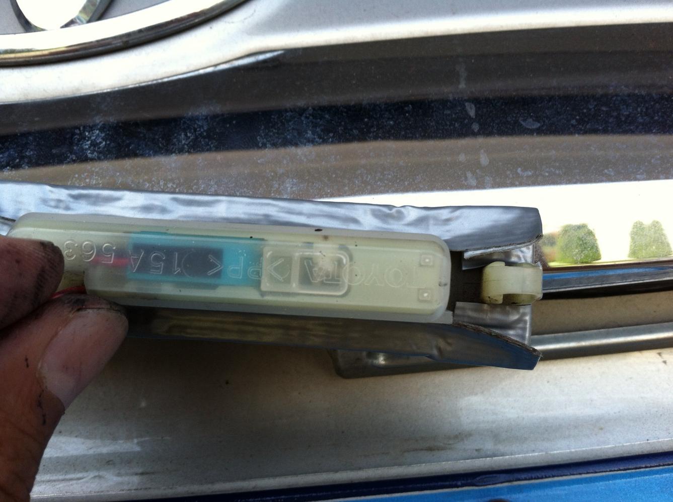

Finally got the sticky messy Liftgate handle out. You do not have to replace with a new one. One thing to note the melted rubber make the actuall plastic switch part harder to move in and out. Once cleaned its much smoother. The rubber cover as you can in the pic is all melted and hardened. You can use a small blade and scrap all the melted rubber out. Try to get as much as possible with the blade.
Then use a rag and rubbing alcohol to get the rest out. Be gentle as you don't want to break the switch assembly as its made out of plastic.

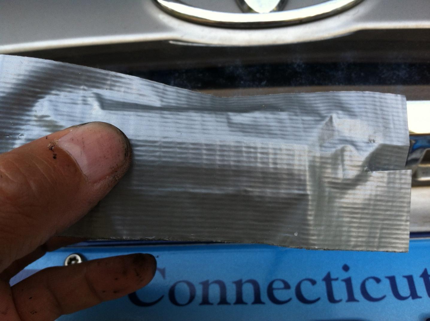

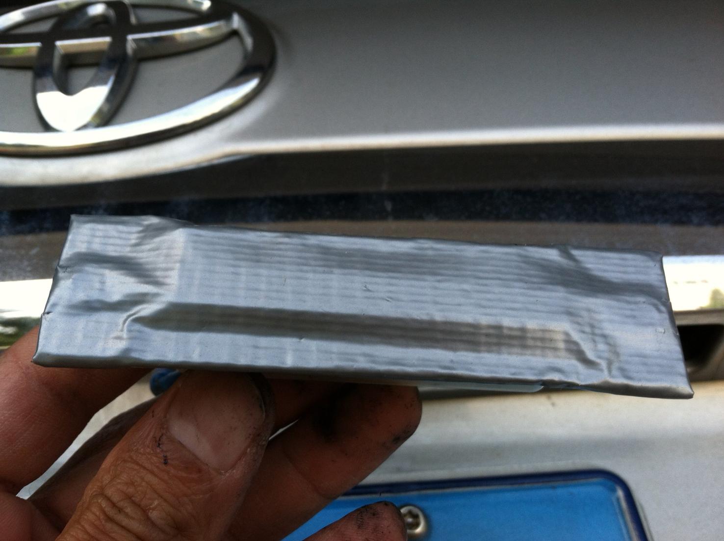

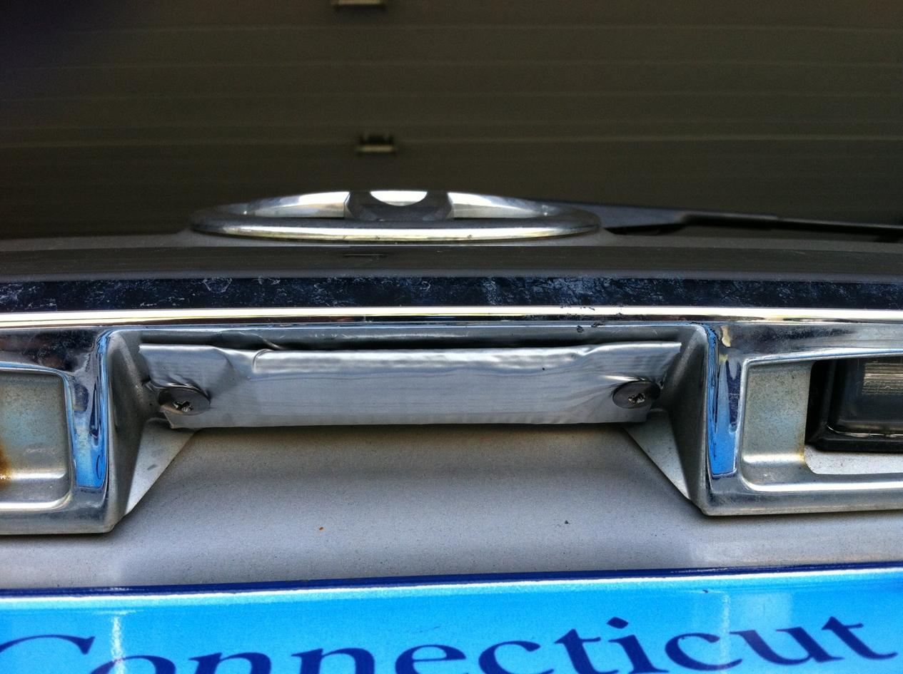

I used two pieces of duct tape and stuck them together just to add another layer. I would have liked to used something better but thats all I had. May be Gorilla Tape. I then attached the duct tape to switch and trimmed so that it can be wrapped around the assembly and seal it. It doesn't seem like water would get into it.
The duct tape setup is definitely a lot better than the cheap rubber cover. Time will tell. :clap2: IMG_3039.jpg
