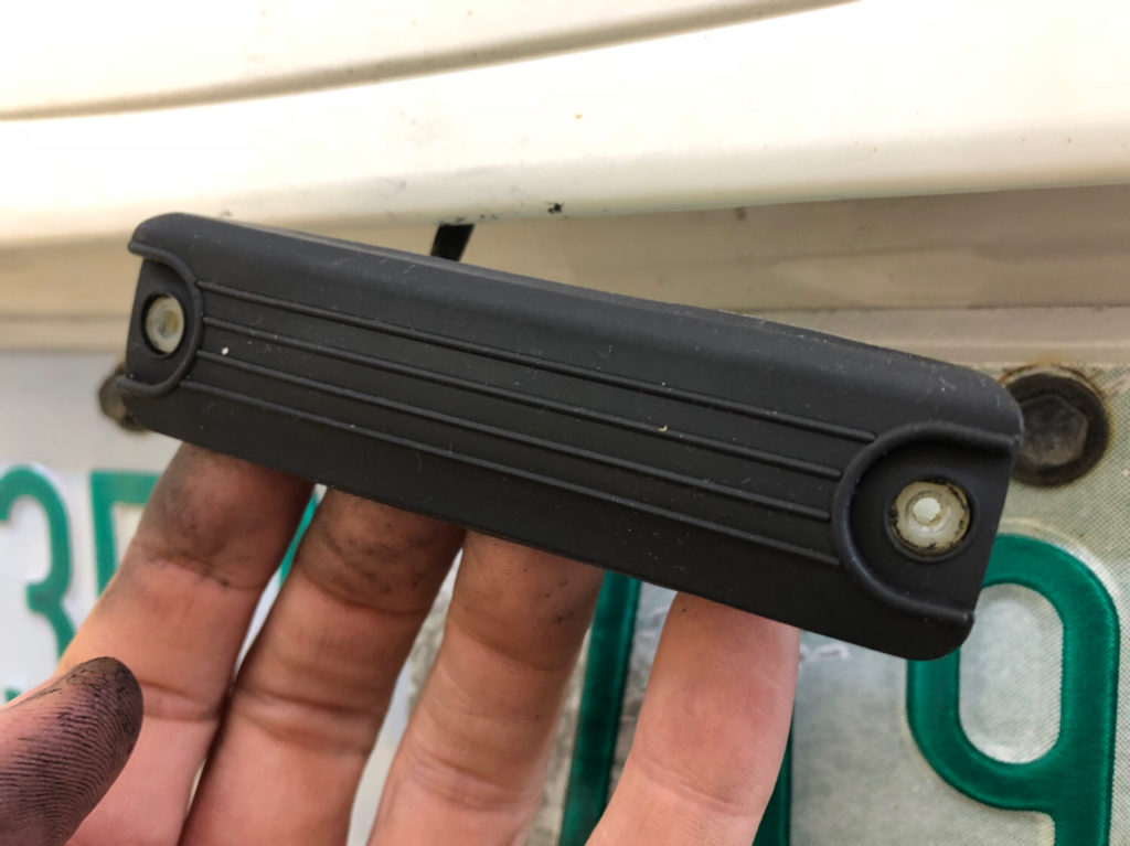

I picked a new hatch button cover on Amazon: New IMPROVED GRIP Replacement Repair KITS for Lexus Toyota Scion Liftgate Trunk Hatch Back Door Handle Switch Release Opening Button Cover https://www.amazon.com/dp/B071DVJ6ZD?ref=yo_pop_ma_swf
Installed it today. Pretty easy jog—just be patient with removing/installing the screws as to not strip the Phillips head screws. Here are a few pics:

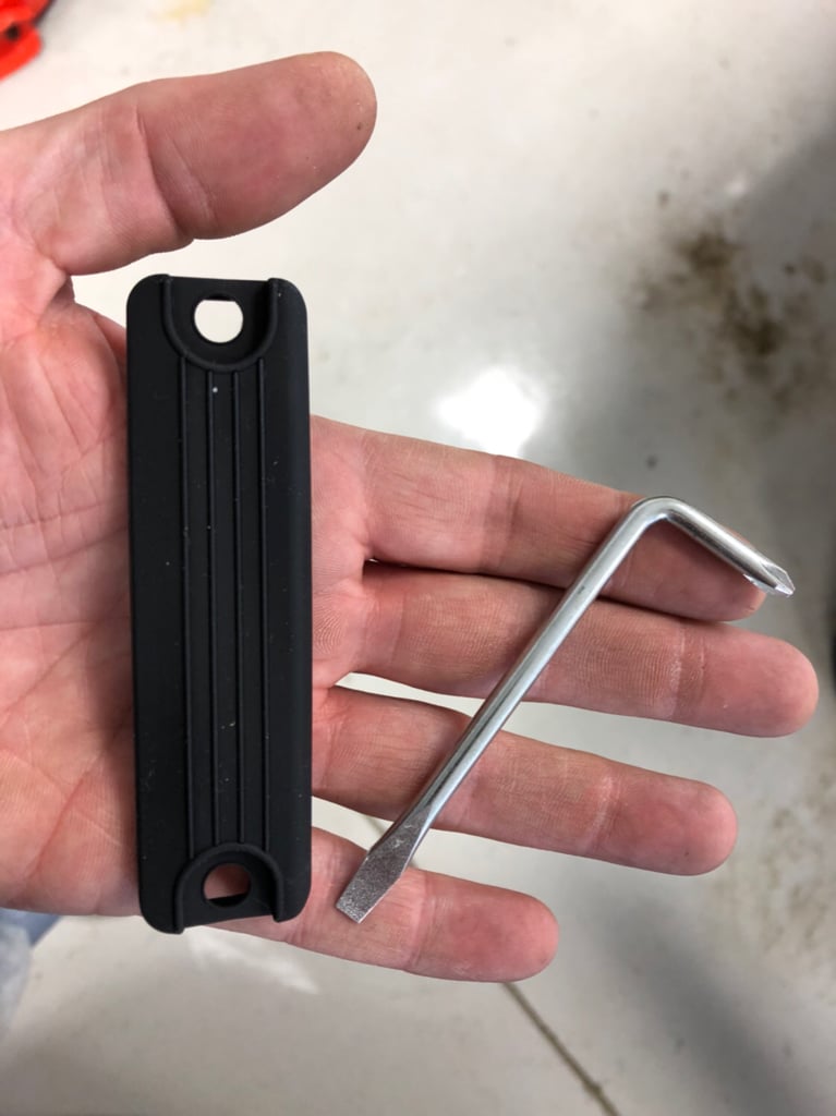

New button cover with angled screw driver:

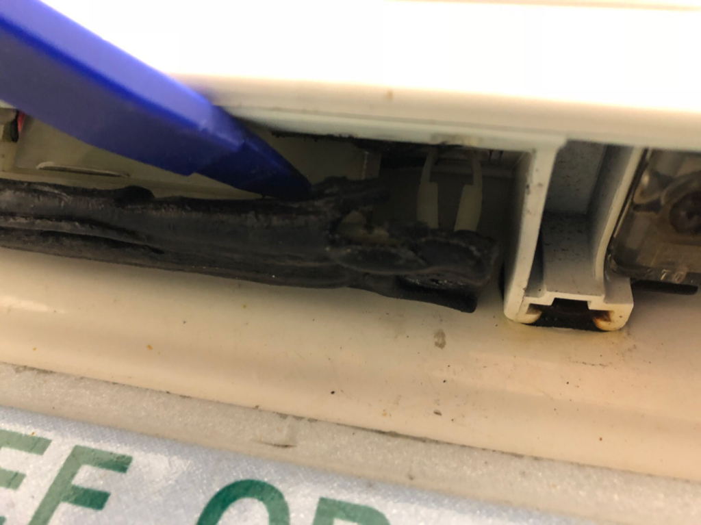

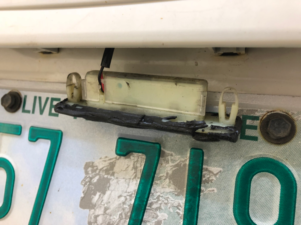

Remove both screws then pry the button out of the slot; it’s clipped in with plastic body clips as you can see a couple pics below:

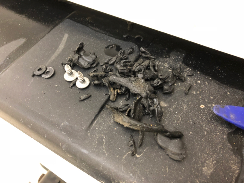

Now the fun part: peel and scrape off the old button. Wear gloves! What a sticky, nasty mess the OEM deteriorating button makes. Here’s the old button in a pile:
Oh, and notice the black washers above! I re-used from the original button; had to peel them from the old rubber.

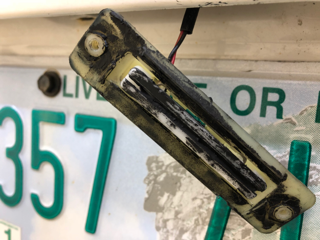

Cleaned up the button as much as I could so the new button cover would go on clean:
When putting on the new button cover, it goes on just one way—you’ll see a more beveled edge on one side of the button and lines up with one side of the silicon cover; just look carefully and you’ll see what I mean. Here she is all nice and new!
