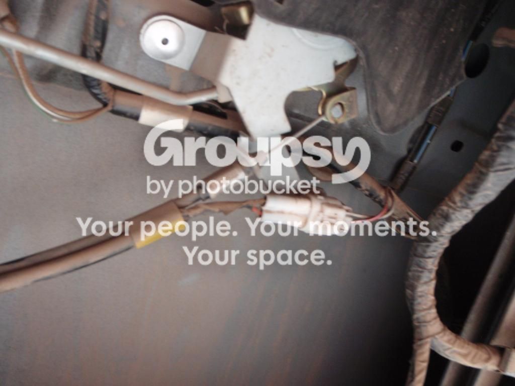

If you find a used one from a part out, it looks like it would be pretty easy to install.
Just disconnect the cable here
P1050988_zpsfbb1e8f5.jpg~original

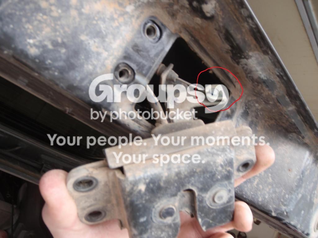

and disconnect the wire here
P1050990_zps4dfa3d27.jpg~original
yeah i got one from pic n pull but its doing the same thing. figured i need to fix that part first before i get the rest of the door to work.
