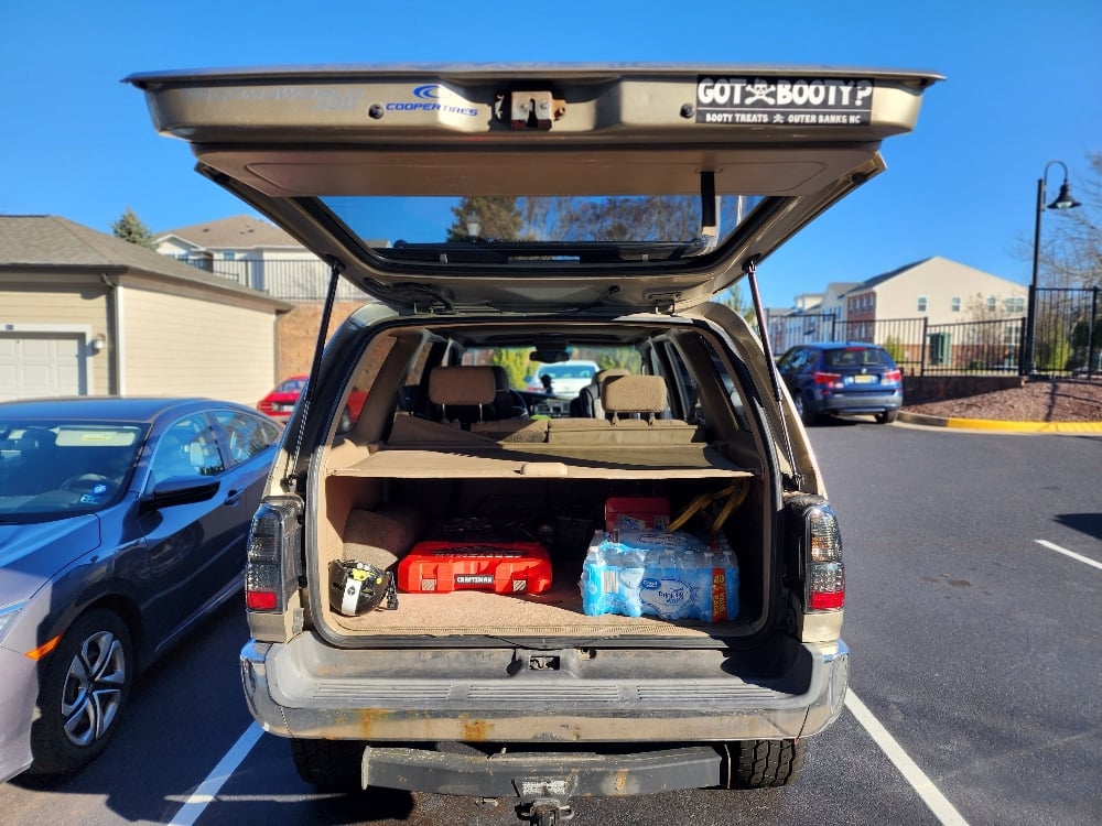

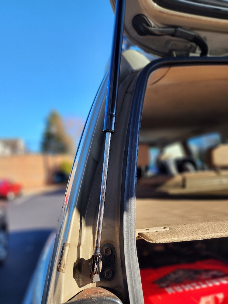

The 6815's are a win for me. Here's some photos. I'll post the rest in my build thread.
