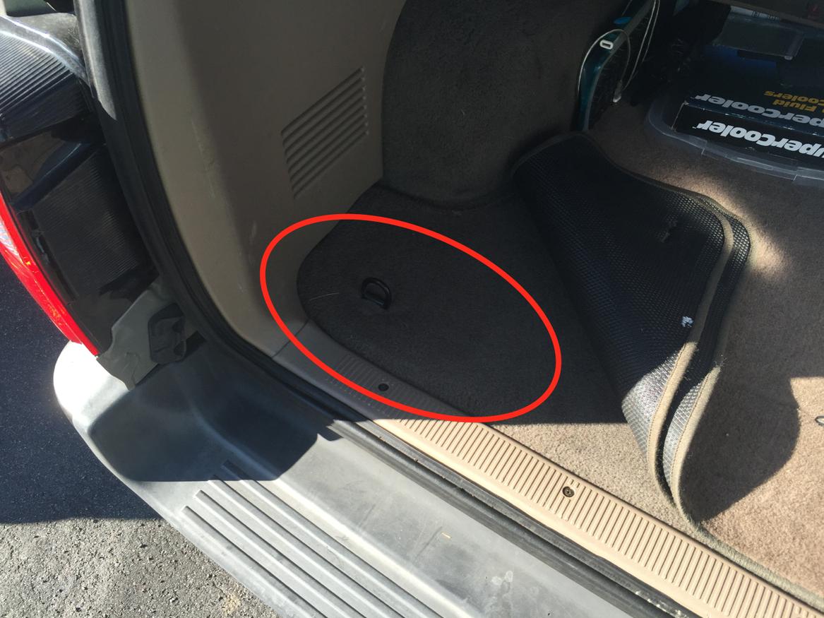

infamousRNR Senior Member Nov 26, 2014 #1 any ideas on how water is getting my rear carpet wet?... .....its wet underneath the mats.. not on top.. so its curious . Attachments Screen Shot 2014-11-26 at 2.31.21 PM.jpg 132.8 KB · Views: 400
infamousRNR Senior Member Nov 27, 2014 #3 [MENTION=75720]my92t4r[/MENTION] no its clear and clean at the top when you open the trunk hatch
N nissanh Senior Member Nov 27, 2014 #4 May be through roof rack bolts? Remove the and apply some silicone?
UnderFire New member Nov 27, 2014 #5 nissanh said: May be through roof rack bolts? Remove the and apply some silicone? Click to expand... Probably this, pull down the headliner in the back and you'll most likely find water, other than that maybe the hatch seal but I doubt it.
