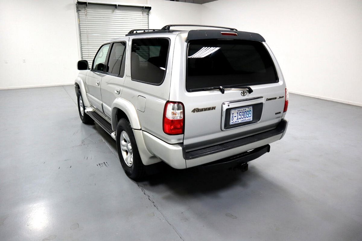

Are the rear license plate trim garnish pieces interchangeable for the 3rd gens? I'm looking to put a 2002 garnish similar to this one on my '96. Purchasing online sight unseen and would like to confirm before purchase.

There are 'early' and 'late' style license plate garnishes. So, 96-98 and 99-02 are compatible. They may bolt up between the two versions, but the outline on the hatch is different.
The chrome one in the photo was 02 only, but the shape matches with the 99-02 style.

thanks for the info...I was hoping that wasn't the case...a new one is $380 CDN!
I have an older style trim on my '99. It bolts up perfectly, but the older style trim is slightly smaller so you will see a little more paint from the hatch.
