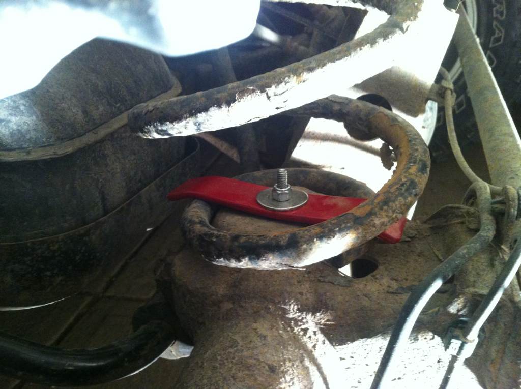

Hey Guys,
I just recently purchased the full bilstein lift kit for my 03 limited. My shop just called me and said when taking the air suspension out from the rear there is no retainer for the rear spring to sit in which is taking the place of the air bag. Im quite annoyed that toy-tech never said anything about this issue since I own the limited with the rear air suspension.
Any help would be greatly appreciated since the truck is at a stand still right now.

You need the spring seats from a 4Runner that came with coils from the factory for the top of the coil and then something like this for the bottom. 1/8" thick piece of steel with a bolt nuts and washers to hold it down.
You'll also need new bump stops or "bumpers" according to the parts catalogue from a 4runner that came with coils.
assuming an 03 takes the same parts as an 07.
you need part # 48306-60180 x2 (bumpers)
and part # 48302-35040 x2 (spring seats)
and two hand made tie-downs like in the picture.
