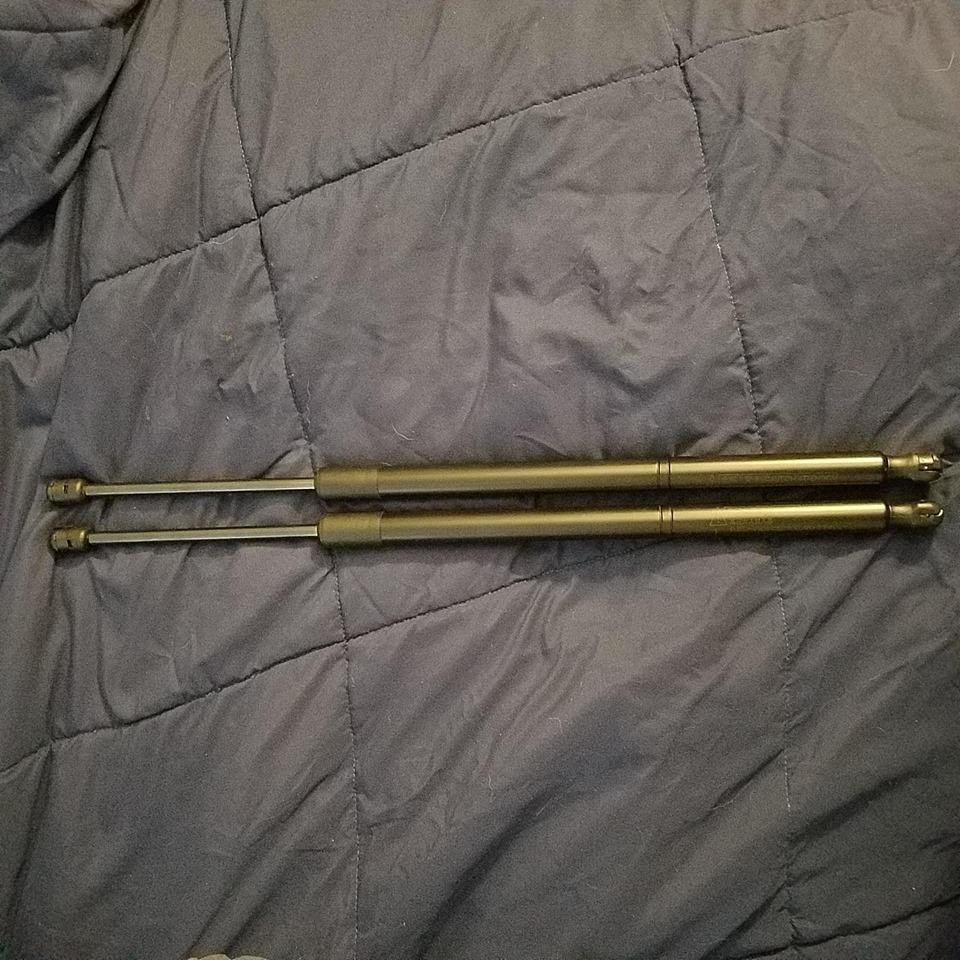

For sale $30 OEM tailgate struts off my 2016 SR5 with 3000 miles on them
