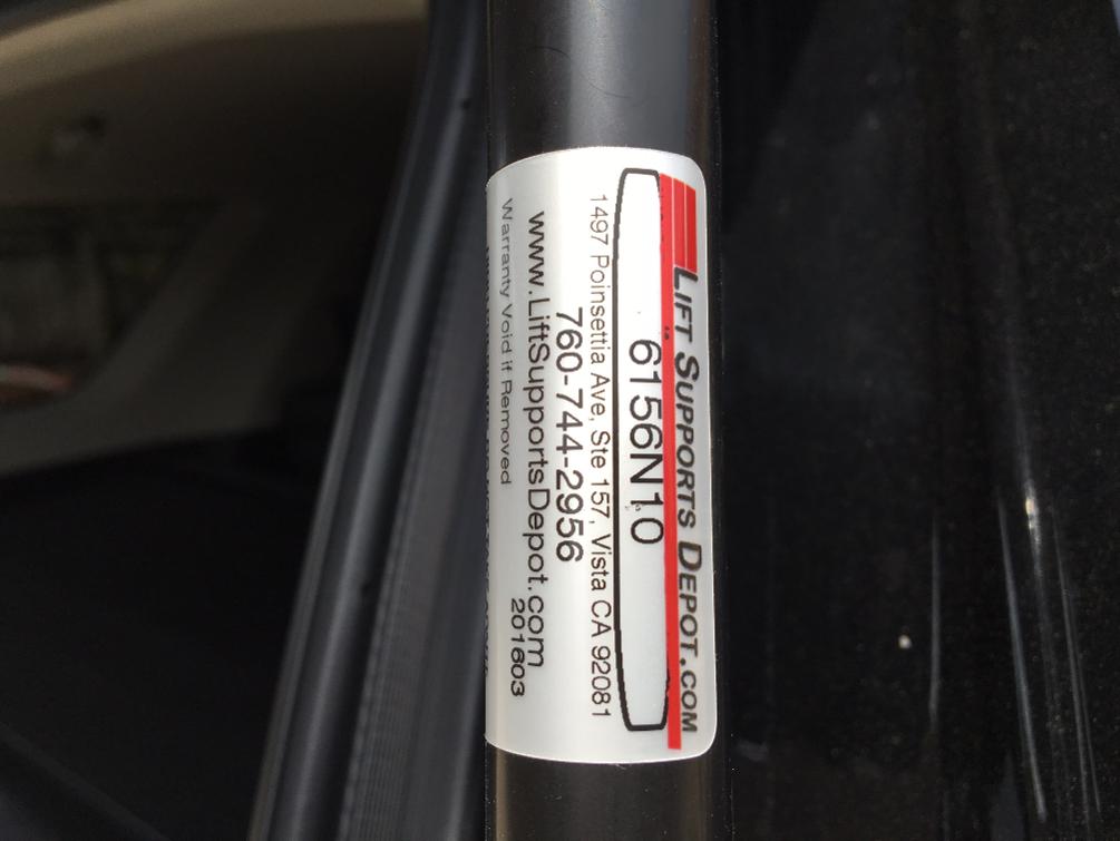

I had ordered struts from Lift support depot for when my gobi came. Got the ladder on and went to put the new struts in, they do not hold the lift gate up at all! It slams down. As well it only lifts up about 2/3 of the way open.
This is what I'm using:
Lift Supports Depot 6156N10 Gas Charged Liftgate Lift Support
same as the ones rec. and in use above.
this is on a 2015 trail.
any ideas?
So on further inspection the 6156N10 labeled struts I was sent are 21.25 inches extended instead of the 22.7 that they should be as per Lift Support Depots site specs. I suppose I got a miss labeled set? Lift Support Depot's Customer service was great and they are sending me out another pair.

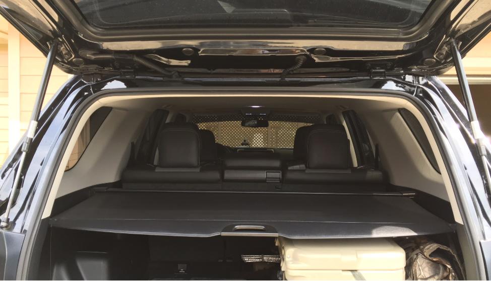

I had to replace mine with the Gobi storm arms (I have the rear ladder). The worked just fine,but were a little slow before that. I actually have the old ones if anyone is interested in buying them. They are just collecting dust in my garage at the moment. Send me a PM.
