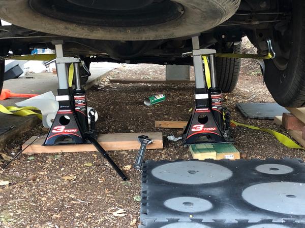

That said, once I got out the lifting jack stands, it went fast actually. Not the best photo...
Coupled with the straps, these worked well. Raising and lowering the axle effectively shortens or lengthens the arms, allowing one to get the holes nicely aligned. The ratchet straps do most of the work, but on each side, the sweet spot was between two clicks on the strap's ratchet. Raising or lowering allowed for the fine-tuning to get them just right.
Because of house remodel project in the garage, I did this on the dirt though, which sucked.

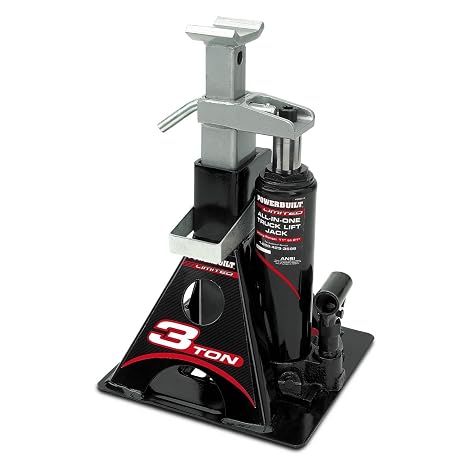

Lifting jack stand, what is this sorcery of which you speak? Lol

Bought them a few years back to work on my friend's vehicles (mine are/were too low) and my old Jeep truck. Pretty neat. A bottle jack incorporated into a jack stand.
Really handy when there are limited jack points. You've been there before... Use a floor jack to get a jack stand in place, but the dang floor jack is the only spot in that area for support, or it's too large to allow sufficient space for the jack stand. No problem with these. Nice to have a pair...
20 bucks in bushings and a couple hours... I did both sides at the same time (not prudent) and it still wasn't that bad. Younger guy like you, probably not on dirt too, you'd knock it out pretty fast.
