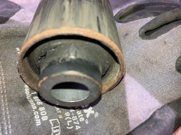

There is a little arrow on the inside of the "captive" rubber bushing in a metal sleeve, did 3- T4Rs and 2 had little arrows on bushings while the 3rd had non-sleeved bushings.
On the 1st rear trailing/control arm I didn't see the tiny arrow and pressed it out in the opposite direction. It's smaller than the one pictured. There was a lot of resistance and it would skip while pressing it thru. On the other arms I pressed in the direction of of the arrow and the bushings smoothly pressed out. I think one side of the metal housed bushing has a little lip hence the skipping. It's sort of like pushing the pin thru on a bike chain that has a unidirectional pin.

Nope, not talking about the upper earlier, non-sleeved bushing. The bottom pic, the tiny arrow is on the middle rubber coated sleeve (it's about a 1/4 of the sized arrow or smaller as top arm).
The arrow points from where the rubber mold dips to bolt side- hold arm straight away from you where you can only see one end of rod-like looking straight at the back of the truck. It'll point towards bolt.
You won't see it if you hold the arm and have both bushings in view-like looking from the side of the truck.

I can confirm that directional arrow.
That said, like Tim, I got them out, all four, not knowing such existed. HEAT, unlike other bushing jobs I've done really makes a difference here. I applied heat while cranking down, and it obvious that it helps.
