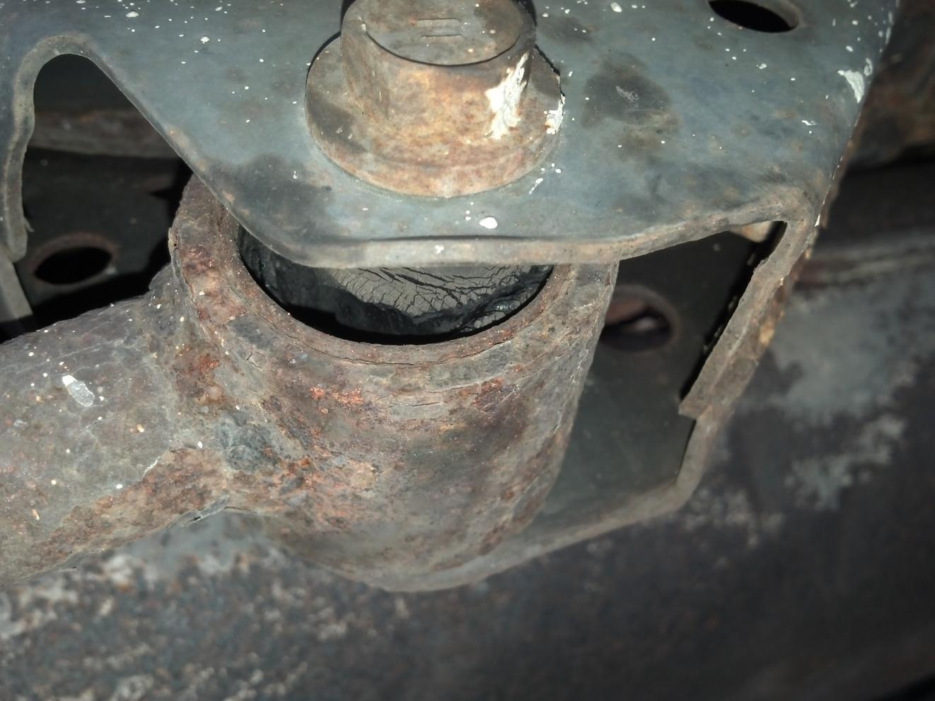

Does anyone have a site they like to find the bushings for this? Napa has em for $25 special order but did see partsgeek I think it was for $15... wondering what the best approach is to removing the old and putting in a new bushing? tried to find a tool at Autozone but they say it's a special order too... am I better off just paying $100 for a new control arm with bushings and if either way, should I do the other side as well? surprised by the lack of info in the haynes manual and the availability of this part... guessing it usually doesn't go bad that often?

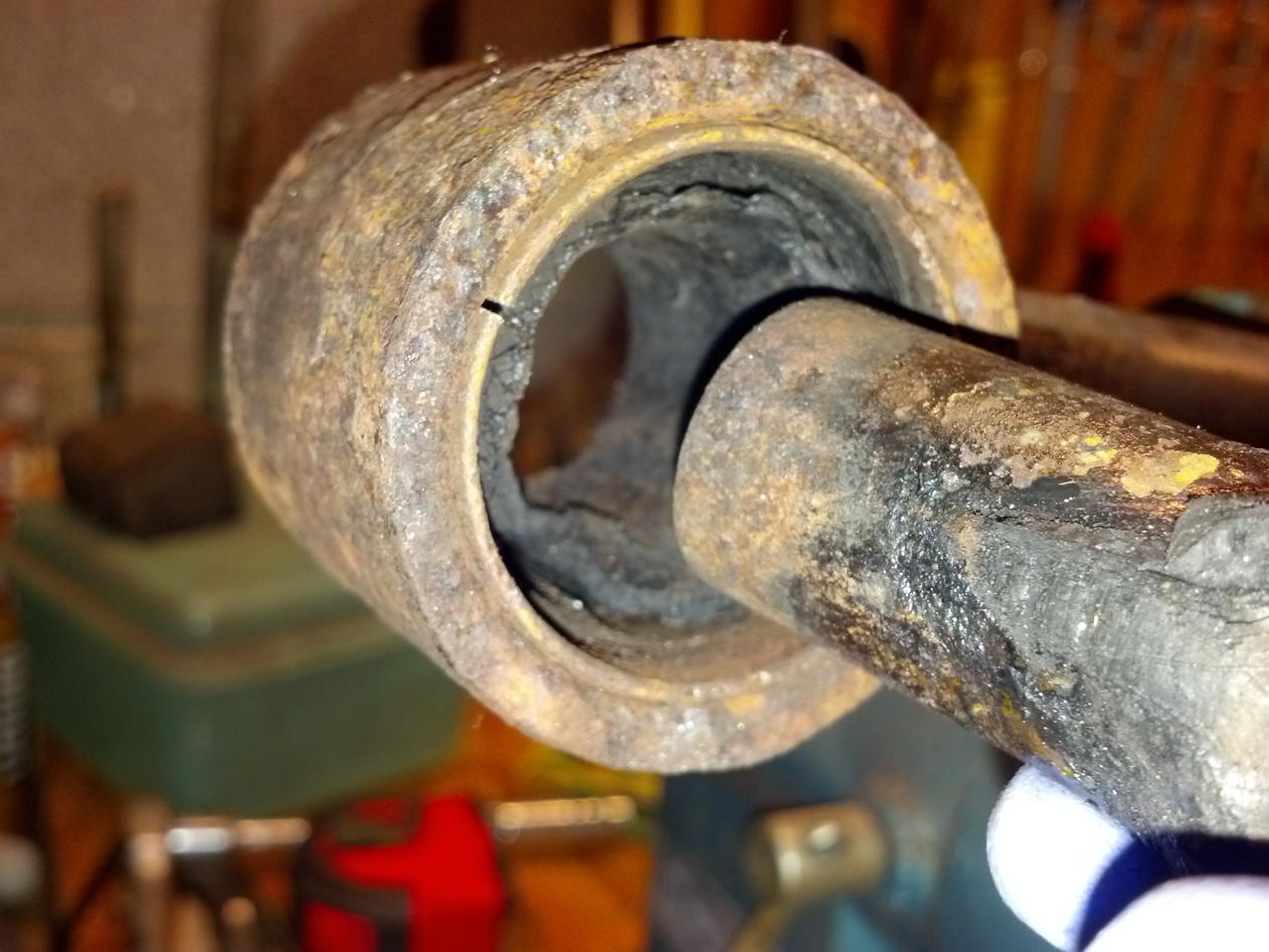

Ok so for anyone interested, I pulled the center out of the bushing and used a sawzaw to cut the outer ring so I could remove better... figured even if I slightly sawed the cylinder of the arm it wouldn't be the death of the part....

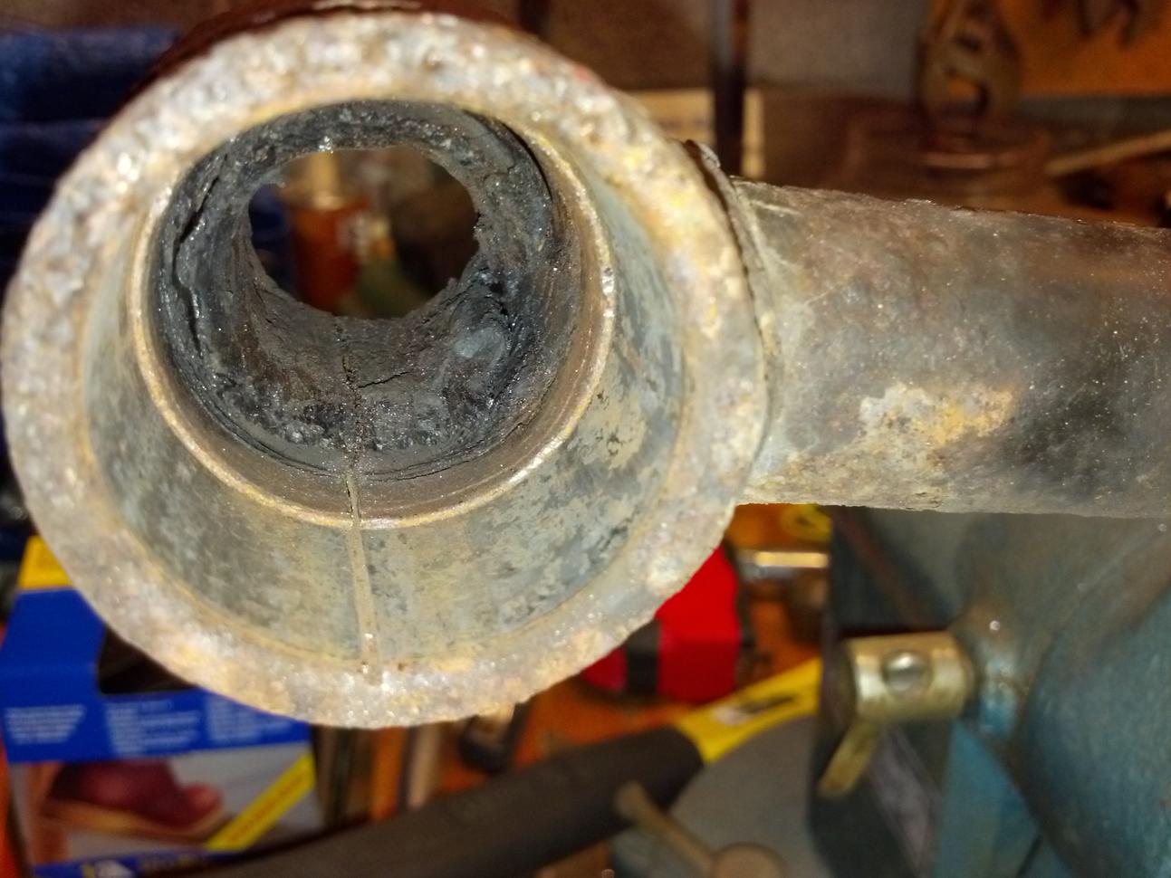

waaahla.... think I read someone else did this as well and guess need to find that post and give em a thanks and good idea.... just waiting for the new bushing I ordered through partsgeek for $15... hope putting the new one in is as easy as it was to pull the old one out once I cut the ring :-)

used thee ole log splitter and a 1 inch open end wrench on one side of bushing (to keep the middle cylinder in bushing from getting pressed)... let splitter anvil push up to the wrench and slowly let the splitter push the bushing into the sleeve of the arm... it went a little crooked but after a quick readjustment, it slid it just fine.... probably should have put an open end wrench on the other end of the bushing once it was pressed in far enough since the metal sleeve inside the bushing is longer than the bushing (thus when bushing was all the way innnnn, the half inch or so of the middle cylinder was being pressed towards the anvil of the splitter thus stretching the rubber probably more than should.... all came out perfect though... $15 part fixed!!! yeeaaa :bravo:

Understood :-) and yes, did put one rear wheel up on a ramp... looked around and still wasn't seeing much... as in the initial picture it's hard to tell until looking VERY closely... I suppose if something was broken or the whole bushing was missing it would have been spotted faster :-) Too see the issue I just needed more than a scan with a flashlight... really had to get my eye CLOSE to these bushings to check for anything out of the norm...

If you look in the first picture I believe you can see the muffler in the foreground... now notice the slightly grey material on the muffler... that would be an attempt to fix what WAS a slight exhaust leak in the seam of the muffler... was minor and the muffler paste covered it up pretty good for a while.... I started thinking about this when I noticed the replaced bushing sorta looked a bit dry rotted as well as the slight tear around that center bushing... and it was only a few months old!!! by this time the muffler was in need of replacement and was on "The List".... but when I got under the vehicle while it was running looking around, I noticed the exhaust gases were sorta shooting towards this bushing... Soooooo, that is my theory on why I had this issue :-)
