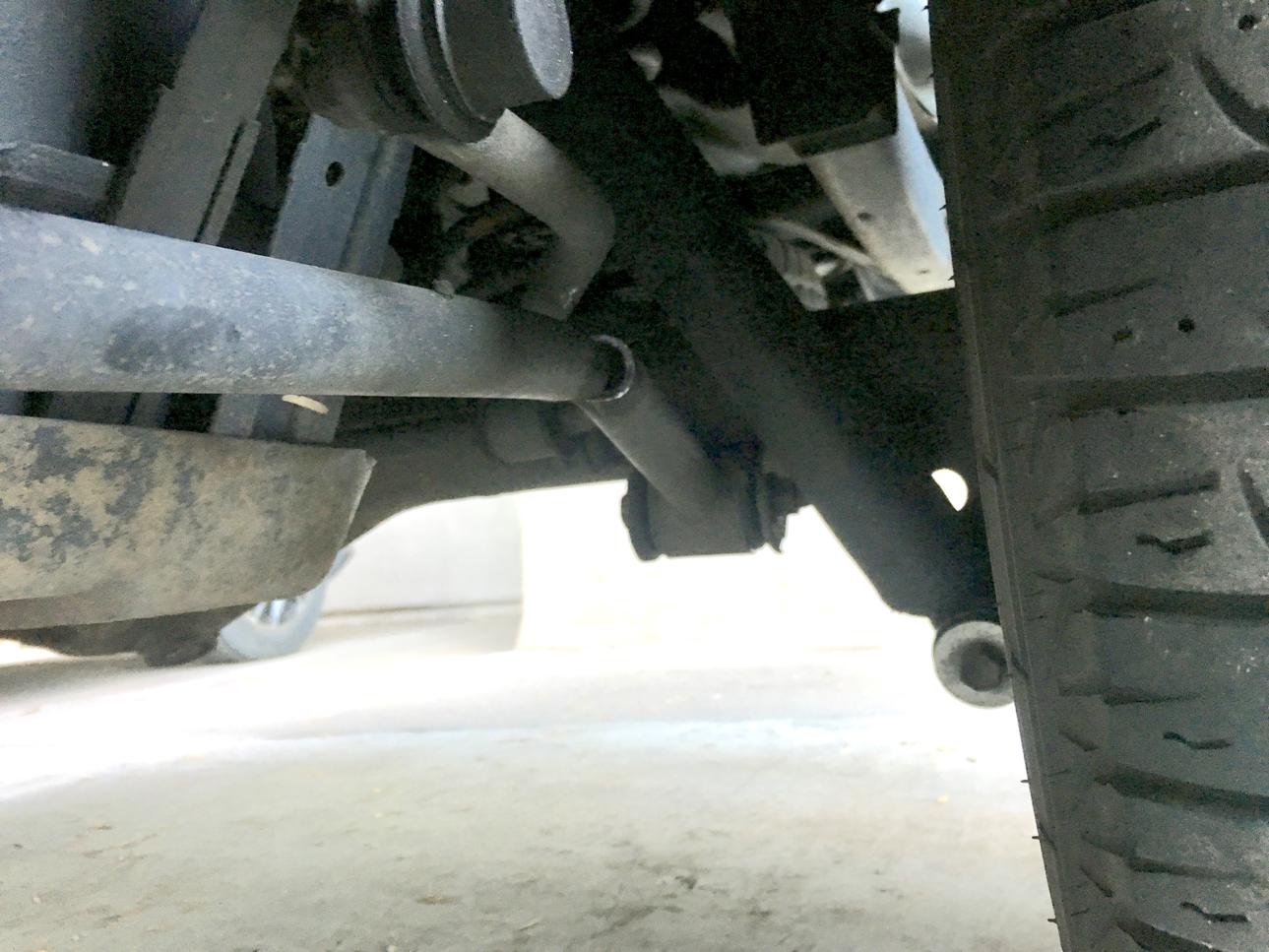

Just finished some maintenance and this happened
I just got done replacing the clutch master cylinder and slave master cylinder. Did the first test drive didn't notice anything and on the second test drive on the highway noticed it was driving crooked a little bit. Would this be something I can tackle or do I need to take it to a shop with the press or something? Rear end lower control arm

Sorry to revive an old subject. My '99 has recently began the "Death Wobble"...or at least that's what is referred too on my old Pathfinder. Wondering if the fix for 4Runners is the same, which was replacing the rear lower control arms. Also, I saw it mentioned earlier in this thread the RA Mevotech might not be the route to go. So what do you long time users recommend for this fix and what brand?
If not, is it more shock related than control arms or a combination of both? Completely new here as I have owned the vehicle for less than a year.

It sounds like you need to stop and take stock of what condition the suspension components are in. If the shocks and rear LCAs are worn out then replace both. I upgraded my rear LCAs earlier this month and have been much happier with the new stability. The old bushings were shot to pieces so they lacked a lot of stability. The rear shocks are on my to-do list but not at the top right now.
Thanks tx_shooter. I just replied to another thread regarding shocks. I'm a little confused as which to buy...
Which LCA's did you buy...OEM or other?
Just get some decent looking OEM LCA's from the junkyard, easy to swap out. The rear shocks on my mom's 4runner are completely shot and it is horrible on bumps but there is no death wobble.
