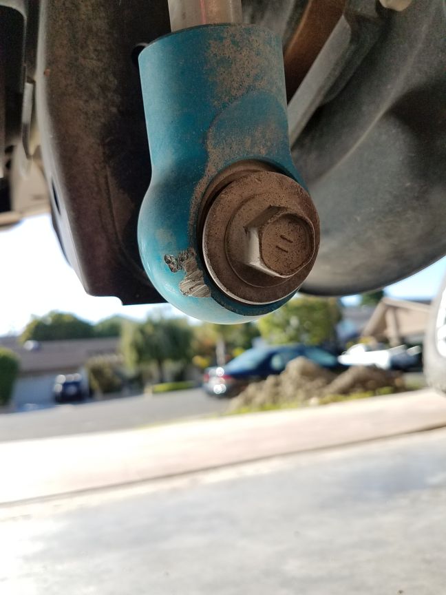

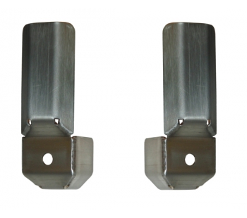

Does anyone know if the Icon Lower Shock Shin Guard is compatible with the King OEM 2.5 shocks? I have damage from rocks and have also noticed pitting on the shaft from sand and such flinging from the front tire. I figure the rocks is my fault and could be avoided with better lines, but the pitting is something that needs to be addressed!! Thanks

they'll probably fit fine. those shin guards should be a required purchase with any set of high-end rear shocks; just like quality UCAs with a set of high-end coilovers.
I run boots now after I demolished my first set of shafts in about 10,000 km.
lesson learned. I wish I didn't listen to every bootless opinion I read online.
My rod ends took a beating too. those shin guards might be the answer!

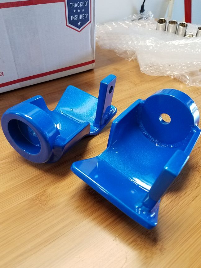

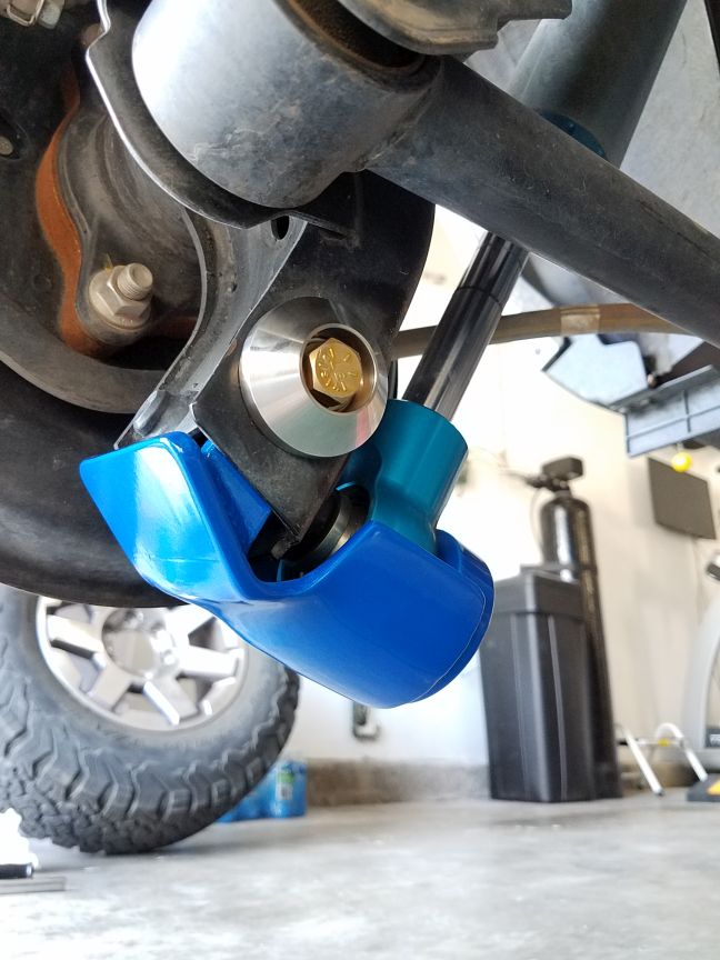

OP here. Wanted to follow up and post what an excellent product FJ Toyman makes. The build quality and fit is excellent and this design is supper strong and will protect the shock bottom end. Now I just need to figure something to protect the shaft from pitting damage. As mentioned earlier, this type of protection should be considered mandatory for any high end shock.

I've run these on my last two trucks, excellent rock protection but reaffirming that you're still going to get some pitting on the shaft if you run these alone.
