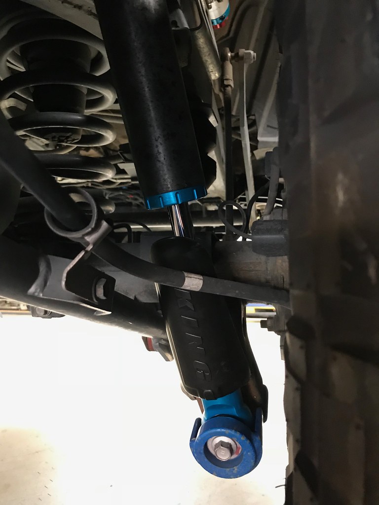

Rear Lower Shock Guard for King 2.5?
Just got mine installed today

Hey guys
Can anyone confirm ICON shin guards fitment with KING 2.5 rears?
FJ Toyman looks tough but no real shaft protection from pitting.. I'm leaving boots as a Plan B
edit: bonus points for pics :D

The Icons are not compatible.
I have something in the works.

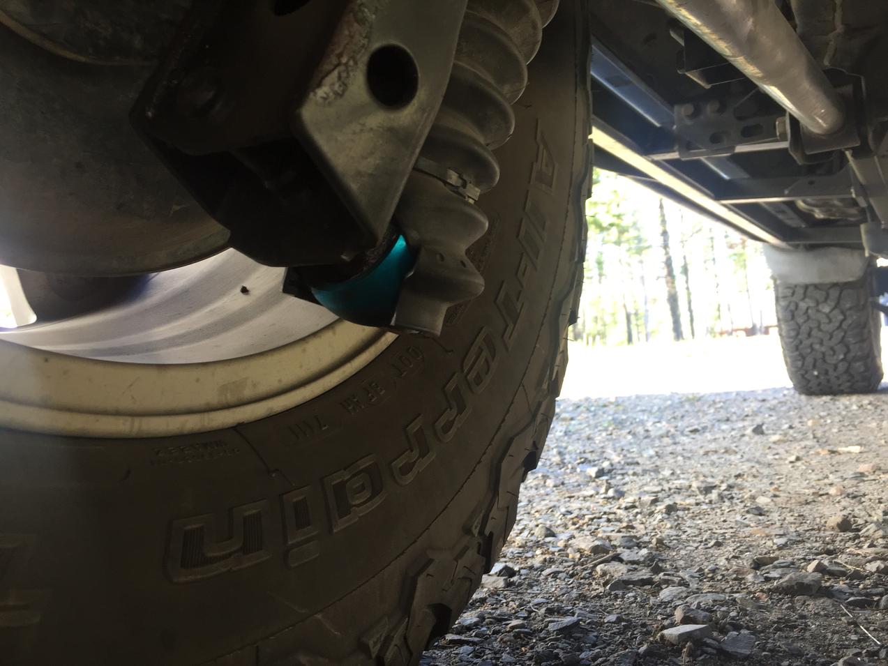

OP here. I ended up just installing cheap Procomp blue boots sliced along the length and zip tie. They may tend to catch and accumulate mud and stuff at the bottom since they kind of make a little pouch collector but I know they will do a great job protecting against the sand pitting. I really like the FJ Toyman skids and how they mount with the side bolt is excellent protection.
good call on the shaft protection

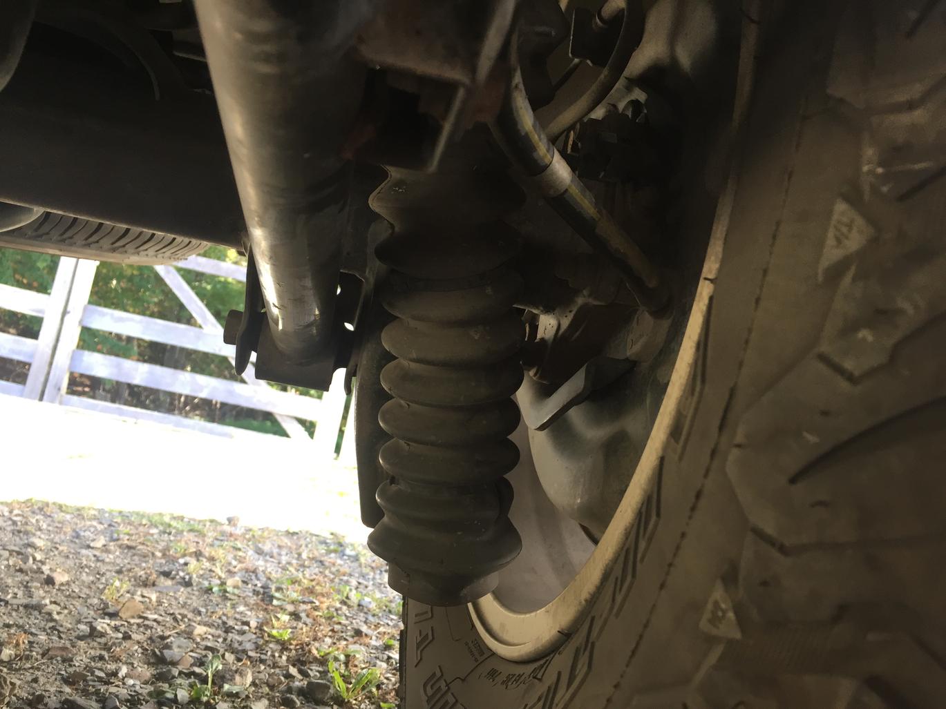

I've got my sliced boots attached pretty low, to keep some junk from hitting the lower spherical bearing. unfortunately with the kings, the lower rod end bearing is the larger 16T ($$$) instead of the com10T.

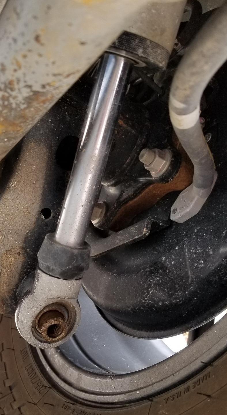

Its definitely a good idea to pick up a set. I grabbed a pair after my first major run through the desert (120 mile trip with speeds of 35-85 mph)... here is what happens when going fast with no shin guards. I have since grabbed a set from metaltech.

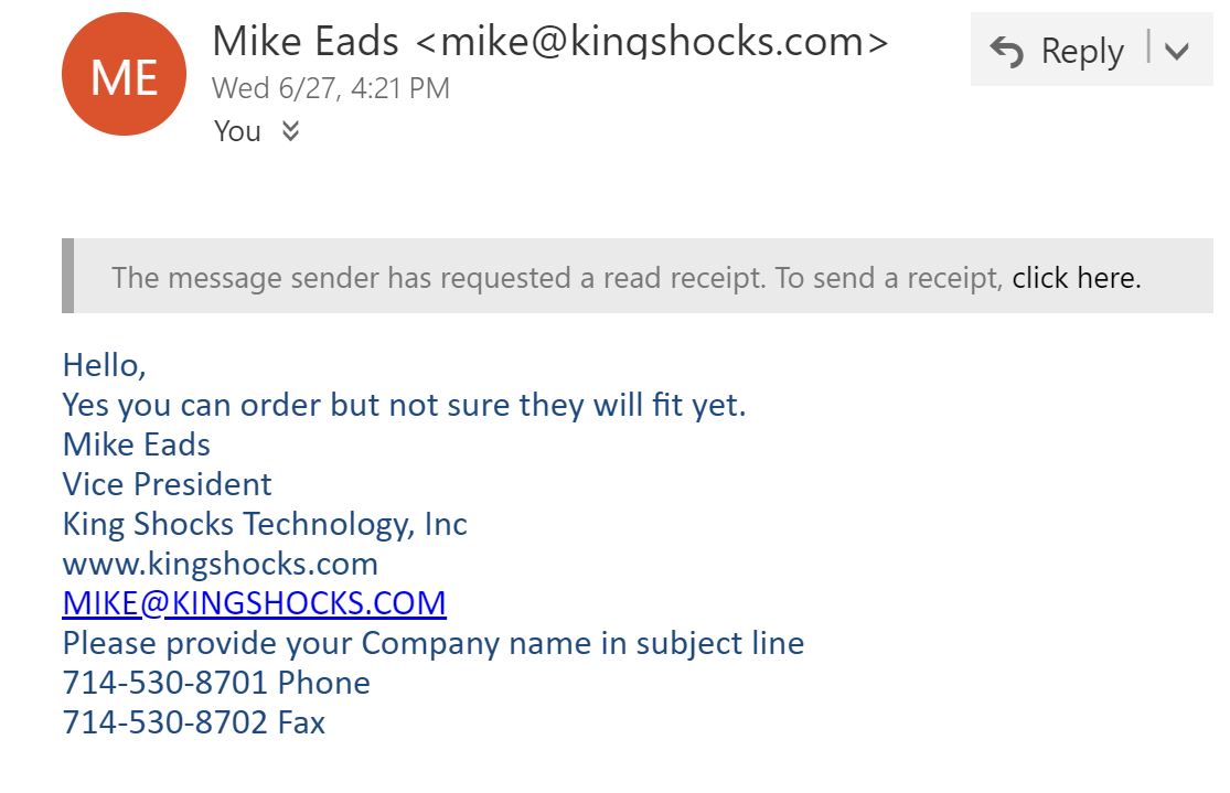

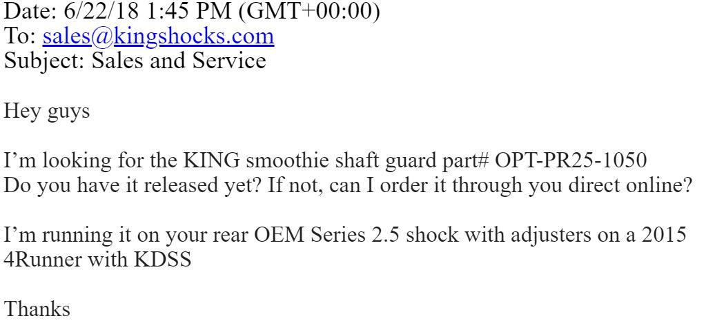

So got in touch with KING for a set, but seems they're still figuring it out. I'm going to wait till it gets figured as I'm not shipping a paperweight all the way out here (screenshots below)

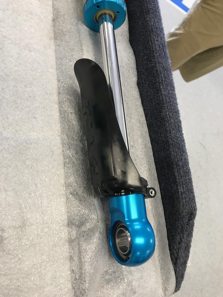

They require updated rod mounts to work. I was in SoCal and had them remove and replace my rod ends and then I could add the shaft guards.
Any idea what's different on the rod ends for this to work? My setup is less than a year old
There's a machined groove that allows the shock guard to lock into.
It's what prevents the shock guard from coming off, the cross screw just tensions it in place.
