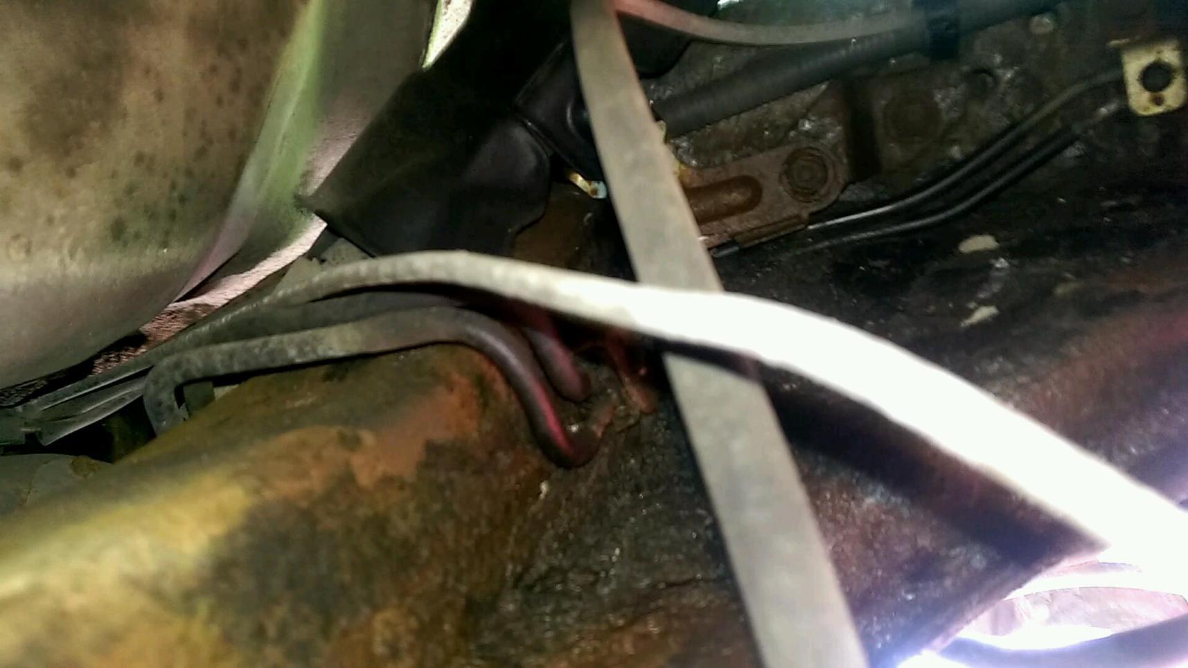

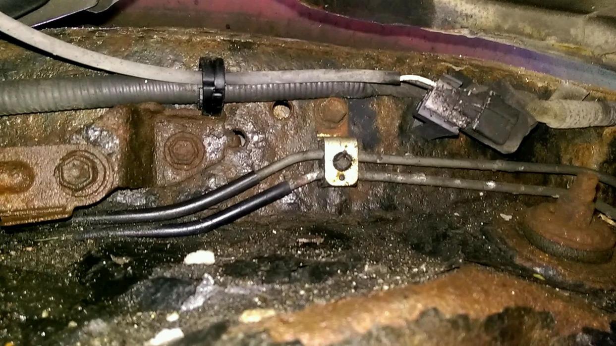

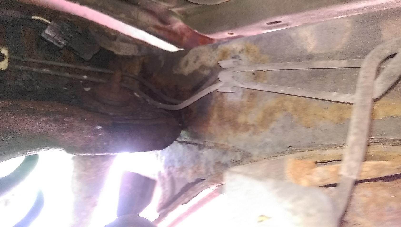

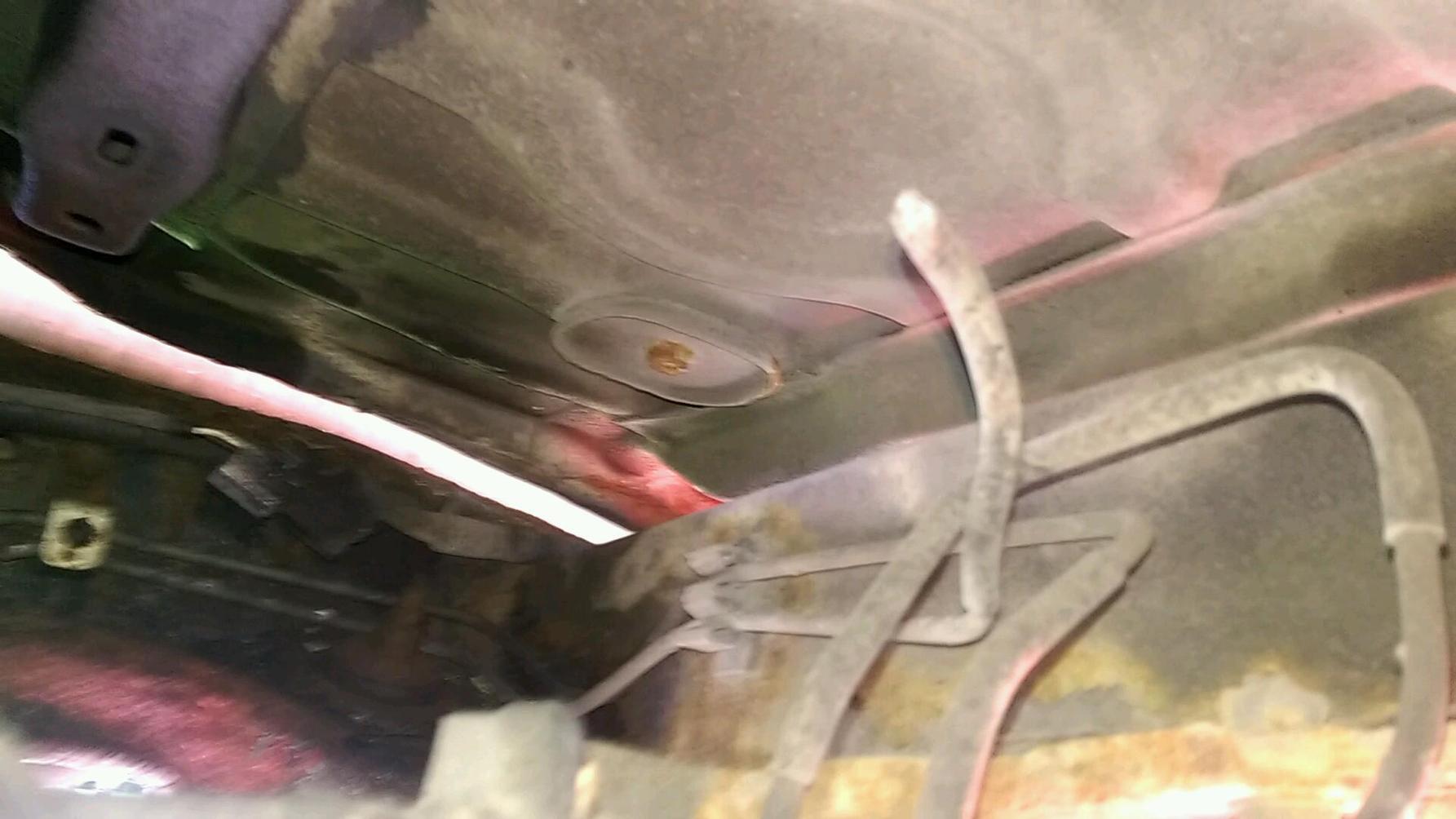

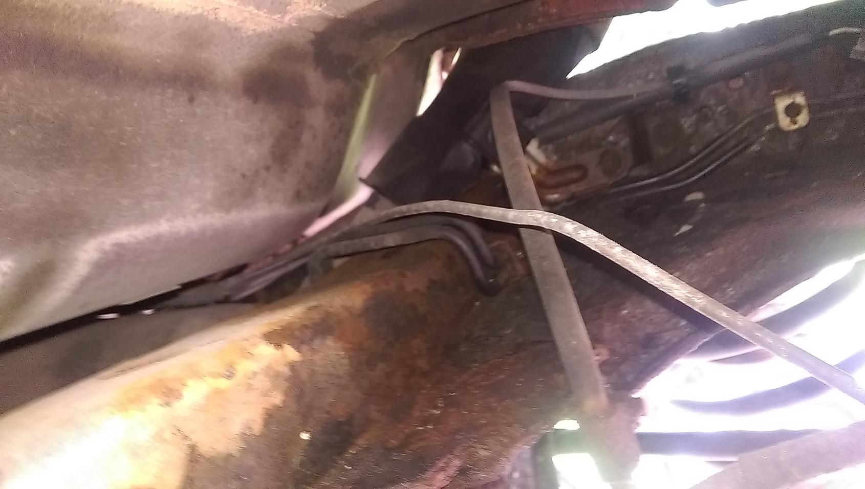

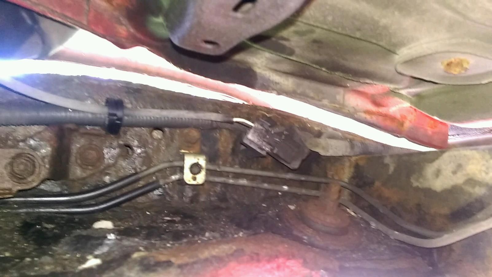

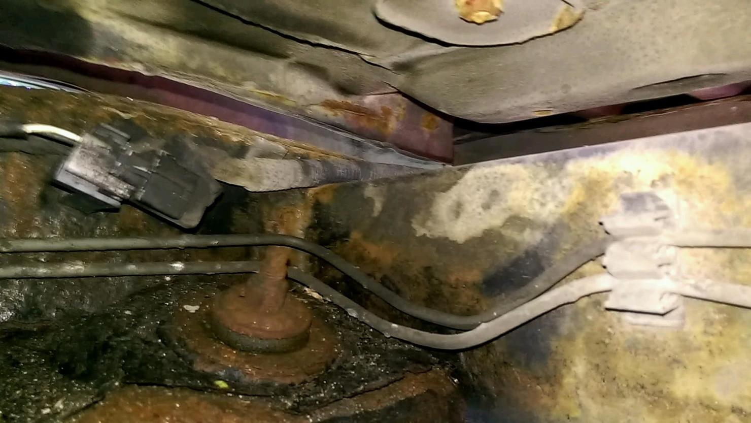

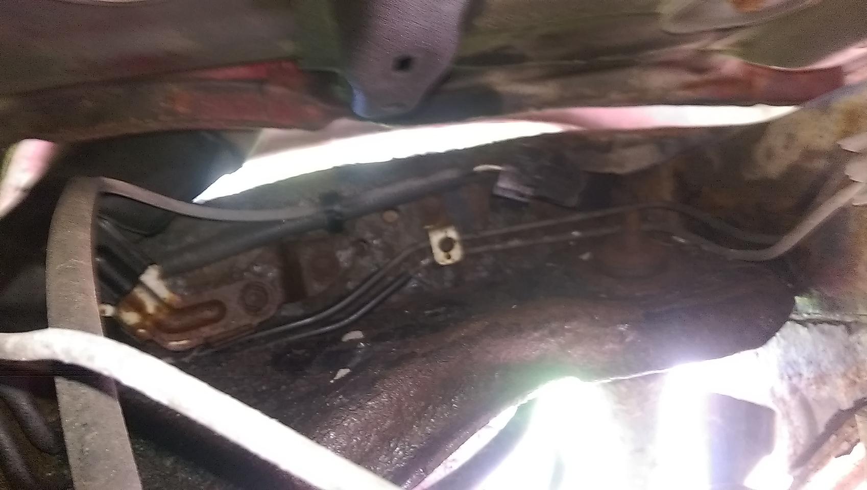

Ok, I was able to trace it and figure out how to run a new line. Looks like the best way is run the new line coming out of the LVPS, and then cut and flange the other piece running along the frame. There appears to be 2 lines that run along the frame, back above the wheel well, and then along the frame between tthe gas tank to the front. The top line is the one that comes out of the LVPS, and the bottom one...is just cut off above the rear axle? It has always been that way since I had it...I will add some pics here soon.
images
Here are the images:
You can see from 1-3 it is the top line. The top line follows around to where it goes into the LVPS. The bottom line??? According to pic 3c it comes around and just ends...I can't tell if it is blocked off. It has always been that way since I got my rig.
Any clue on where 3c is suppose to go or is it just a dead line that confuses everyone?
I was able to take the top line out of the LVPS attach the new line, and I am cutting into the top line where it runs to the front along the frame in pic 1a.
Thoughts??

Can you get a pic of how the lines are configured in the front passenger wheel well? There should be the main rear line on the elbow fitting, and the second line connects to the T fitting with the front passenger line.
