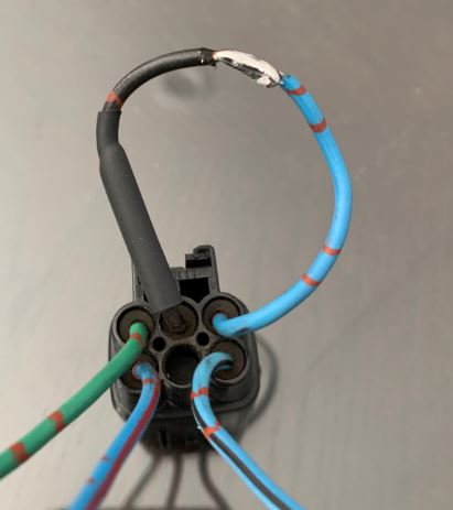

I had the same issue of the rear window not working after I deleted my rear wiper. To fix this you ground number 3 in the connector, either by using a small length wire to jump or you can like I have use the pig tail off the old wiper motor to do this.
