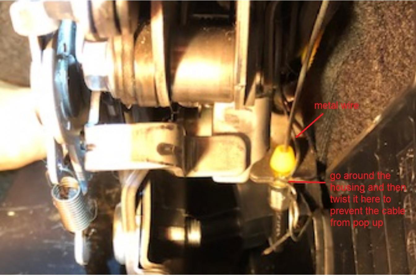

9. To prevent the cable from pop-up, tie a metal wire around it and the metal housing after the cable is attached back to the metal bracket.
10. Then twist and tighten the metal wire.

Here is an enlarge photo here to for Step 9 & 10 in my original post.
You would need a needle nose plier to thread the metal wire through the tight area and pull it out around the housing, then twist it at the cable to prevent it from pop out again.

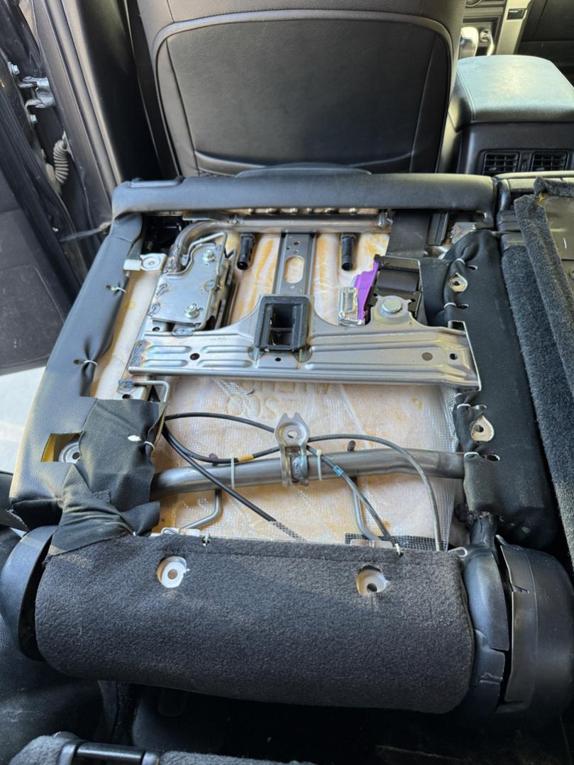

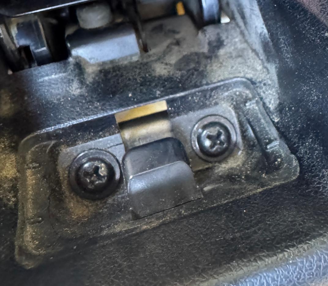

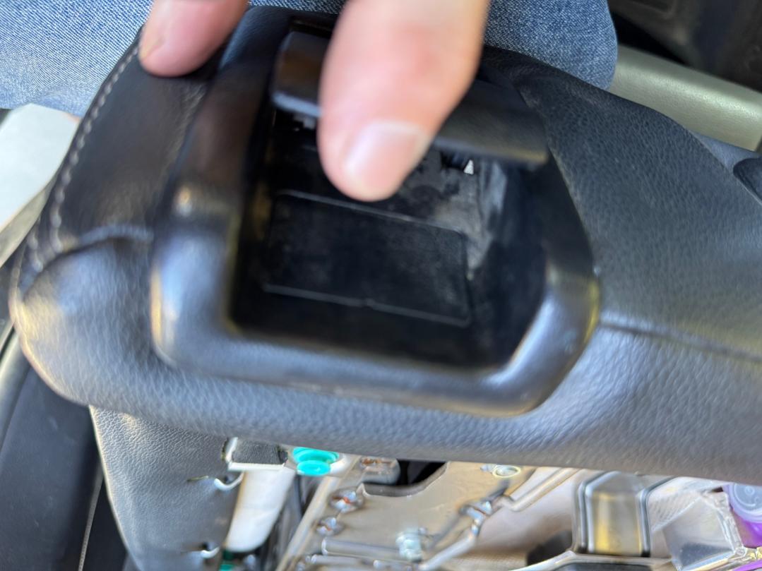

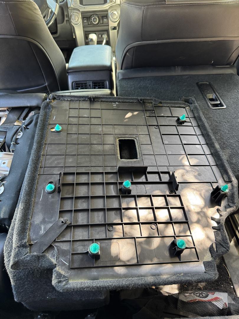

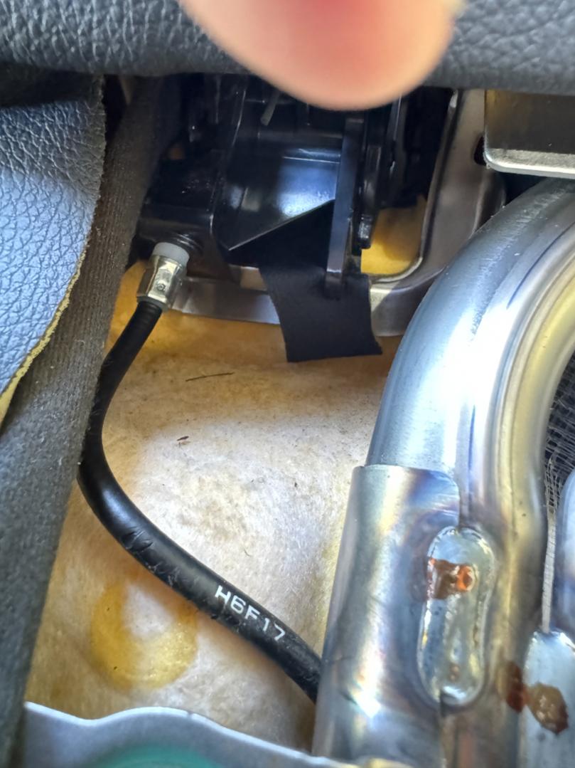

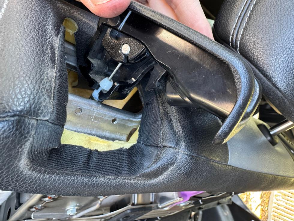

How to fix the Driver's Side.
If your driver's side rear seat won't fold down check the lever first.
My rear seat folding mech. disengaged on my driver's side. Most people seem to have this issue on the passenger side. The cable mechanism is different at the bottom of the driver side seat and more difficult to access since the middle seat prevents removing the cover. You can get in there to barely see the cables though and mine appeared to be attached.
I took off the back of the seat to see the cable more clearly and found the cable had detached at the top near the lever. After trying to reattach it from through the back of the seat I ended up removing the lever and it was much easier.
I attached some photos showing
1) the access to remove the lever
2) two screws to remove
3) what the cable should look like when properly attached from the lever. Note that the end of the cable had slipped out of the metal slot and the plastic end of the cable housing had also slipped out of it's slot. Make sure both are in the proper position.
4) what the cable should look like when properly attached from rear of the seat
5 & 6) the position of the clips if you need to take off the rear panel of the seat.
