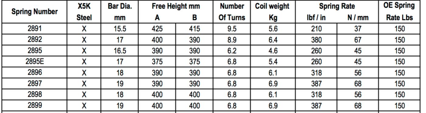

OME does this thing with some of their springs where the spring rates are the same but physical height of the coils are about .5" apart (if i remember correctly).
your 898's are the same as their 896 in spring rate with your coil being taller.
same with 897 and 899. i feel like the 899 would be really tall but i guess that would all depend on how much lift you're running up front. i try to keep mine reasonable with the Kings so the 897 work well for me.
