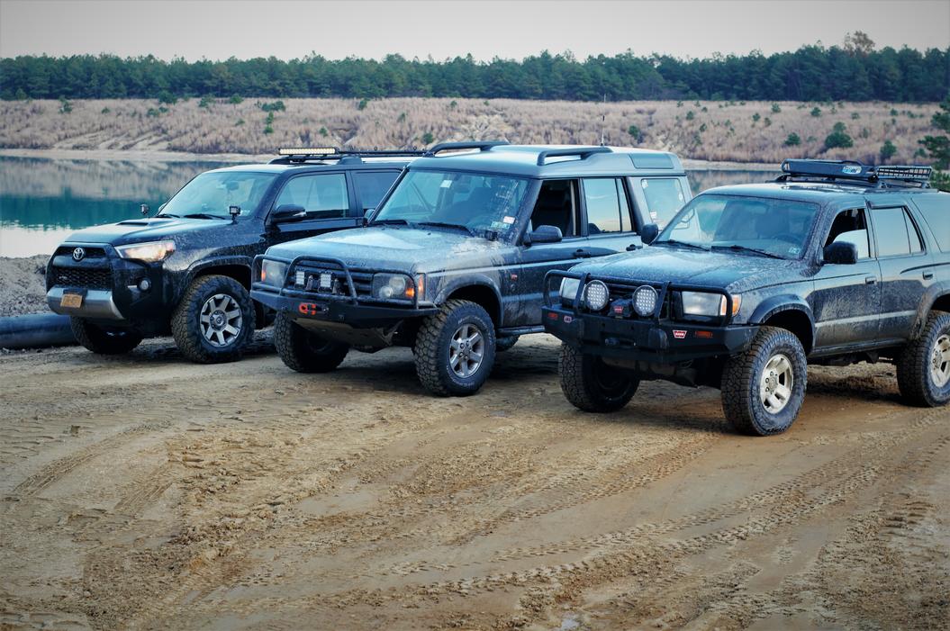

try ome 906 it will sit level thats what i have n my 3rd gen 4runner
