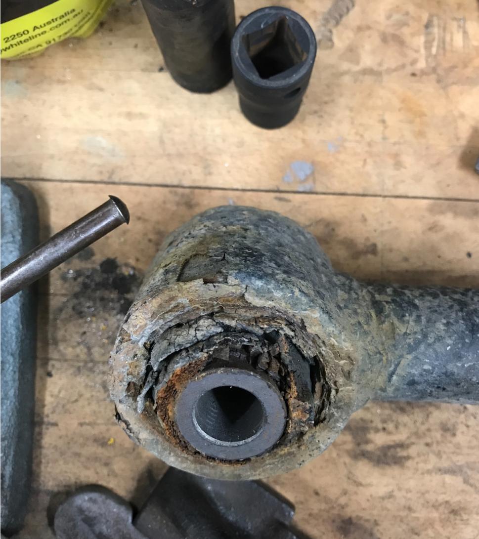

Finished replacing the rear lower control arm bushings.
What an improvement as the originals were toast.
Next up, upper arms and panhard.
Any install tips?
Any install tips?
2nd verse, same as the first....
Panhard was the easiest of them all. I had issues with the rear control arms and getting the axle to line up nicely, so plan on using a comealong or heavy duty ratchet strap, probably a jack or two and maybe a prybar to help get everything lined back up again.
And wow, that's crusty... glad I bought a TN truck and live in GA
