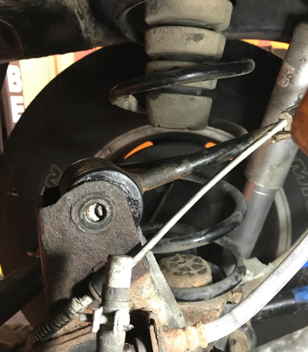

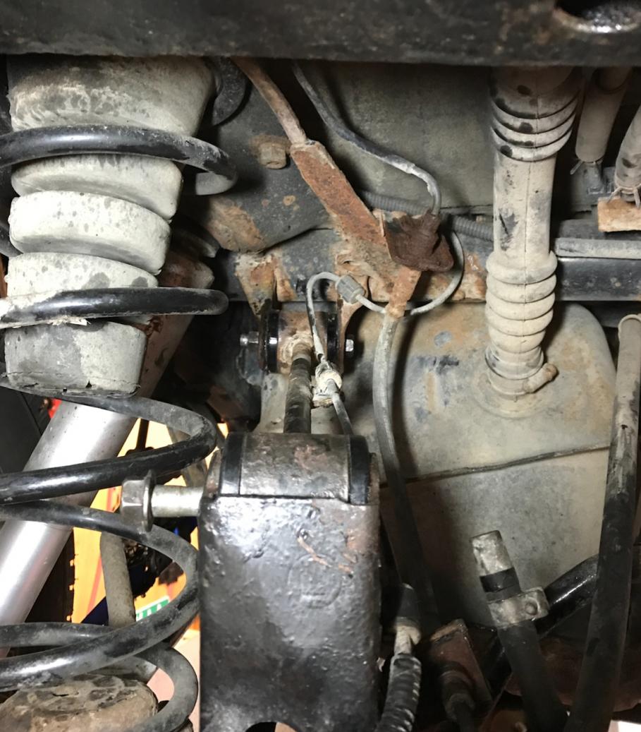

Replaced all bushings on lower arms, panhard, and passenger side upper control arm.
The last bolt on the driver side upper control arm is giving me a fight.
Expected an issue as they (front & rear bolts on this arm) were tough to remove.
Rear frame rails supported by stands and wheels suspended, no load.
Have ratchet strap pulling driver side of rear axle assembly forward and 3rd member supported by stand.
Tried just about everything to get this bolt to line up, raised & lowered 3rd member, released & tightened ratchet strap. Even tried a “C” clamp to pull the arm back against the bracket …..no luck.
Suggestions welcome and appreciated.
Pretty sure that's the one that gave me the biggest fight too. As I recall, I left it loose till I removed the shock (was replacing those also) and that made it very easy... so try popping the shock loose of the bottom mount.
Worth a shot as pretty much out of ideas.
You probably want to have all the other bolts loose back there while you are doing that. You may also have to remove the springs to cycle suspension height to get it to line up.
-Charlie
I haven’t tightened the forward positioned bolt on the upper arm in question and have yet to torque the passenger side upper arm either.
All the other bolts as in the lower control arms on both sides?
It is often false economy to try to leave too many things bolted up and in place... At this point, it is worth a try to loosen up the bottom arm bolts.
-Charlie
All buttoned up.
What finally did it was partially and slowly loading up the rear suspension and raising the rear diff assembly.
Loosened the panhard as well.
Allowed enough wiggle room for the remaining bolt to slide into place.
Thanks to all for the help.
