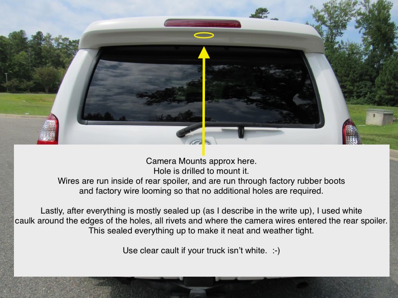

... a second camera, which I mounted in the center on the underside of my rear spoiler. It's approximate location is circled in the photo below (but the photo doesn't actually show a camera... so you're not losing your eyesight. It's the photo... not you. :D ).

For the "upper" camera. I drilled about 3 holes in the to bottom of the rear spoiler... each was about 1/2 inch in diameter. They were slightly off-set, as if to form an oddly shaped triangle, or somewhat reminiscent of the Olympic rings
attachment.php
I ran all of the wires through the factory wire looming (rubber boot)... I had to fish the wires through, and start with a regular piece of speaker wire to get everything started. There was a bit of trial and error, but once I got the first wire through, I used it as a guide line to get the "real" wires through.
I cut a piece of hard plastic about 1" wide by about 3" long, and drilled a small hole on each end to mount it. I used it as a template to drill matching holes in the underside of the spoiler itself. Lastly, I lined everything up. and drilled a small hole in the center of the piece, and cut a small channel so that I could feed the wires into that hole. (make sense?)
Then I carefully placed the piece of plastic INSIDE of the rear spoiler, and lined up one of the holes, and put a pop rivet into the underside of the rear spoiler such that it also went through the hole drilled in the piece of plastic inside the spoiler, and secured the plastic. Then, I was able to use some finesse to line up the holes on the other side, and also put in a pop-rivet. The result was that the wires were now run INSIDE the rear spoiler, the camera was hanging OUTSIDE of the spoiler on the underside, and I had closed off MOST of the holes I made by riveting a piece of plastic to the inside of the rear spoiler.
I drilled two holes to mount the upper camera to the underside of the rear spoiler and pop-riveted those in place too. Then I unscrewed the trim around the camera, and rotated the camera lens itself until the image was correct (not upside, or askew), I bent the thin metal on the camera's mounting bracket to aim the camera exactly where I wanted it, and then I screwed the camera trim down very tightly to make sure the camera didn't rotate.
