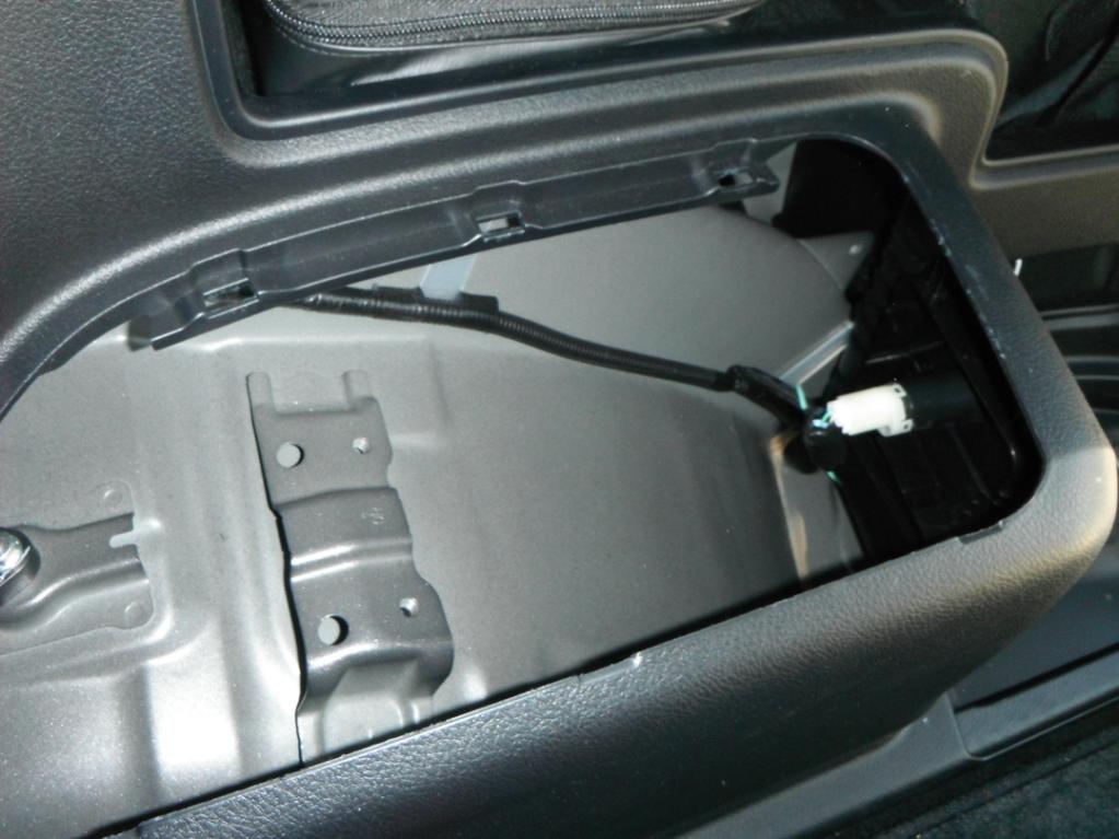

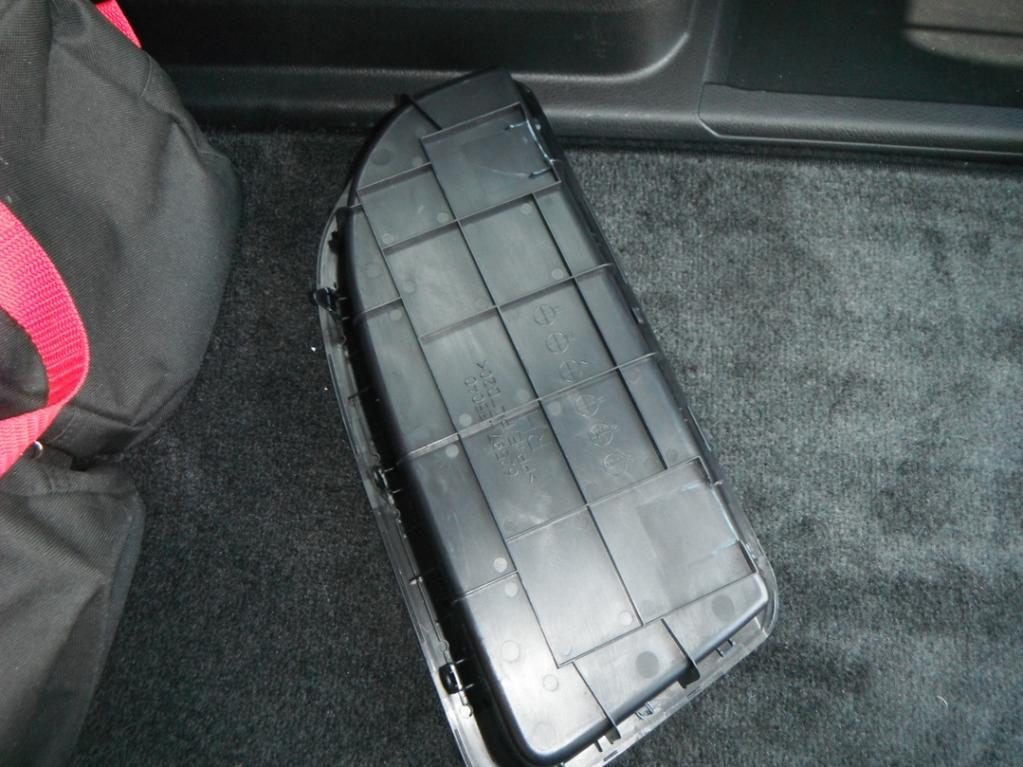

Once again- this was originally Harper7's idea, but here are some pics from my "Brute Force Access" (BFA) method to the storage area :
This is the direction you would pry up on the lids to break the tabs:
I'm pointing to where the tabs break
And here's a shot under a lid, and the amount of space in the wheelwells. I don't have an A/C outlet nor an amp back there, so I have a pretty good amount of space.
Break away, gentleman :banana:

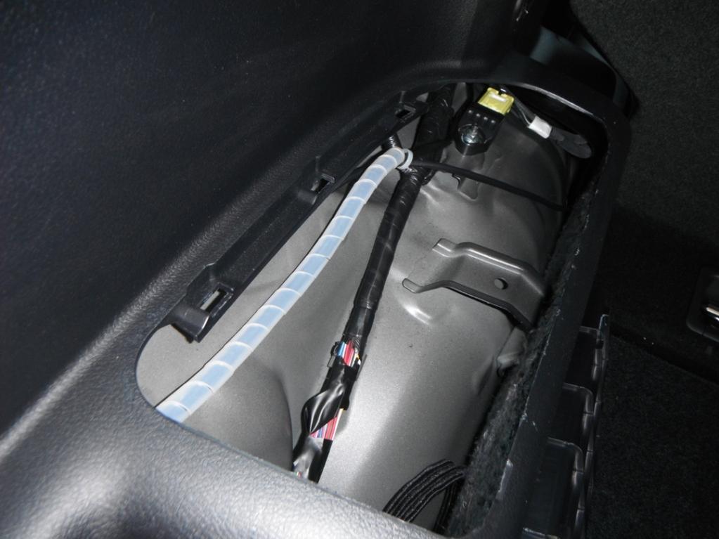

Here are some pics from my "Brute Force Access (BFA) storage area :

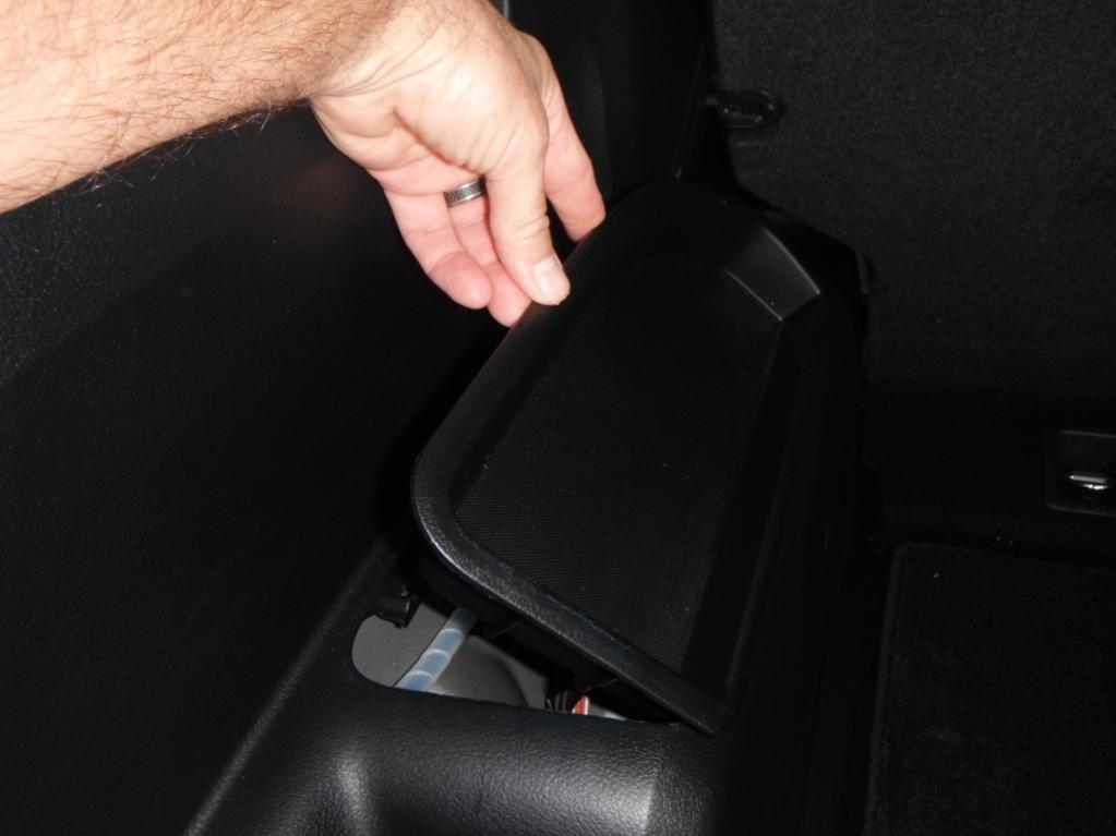

This is the direction you would pry up the lids to break the tabs:

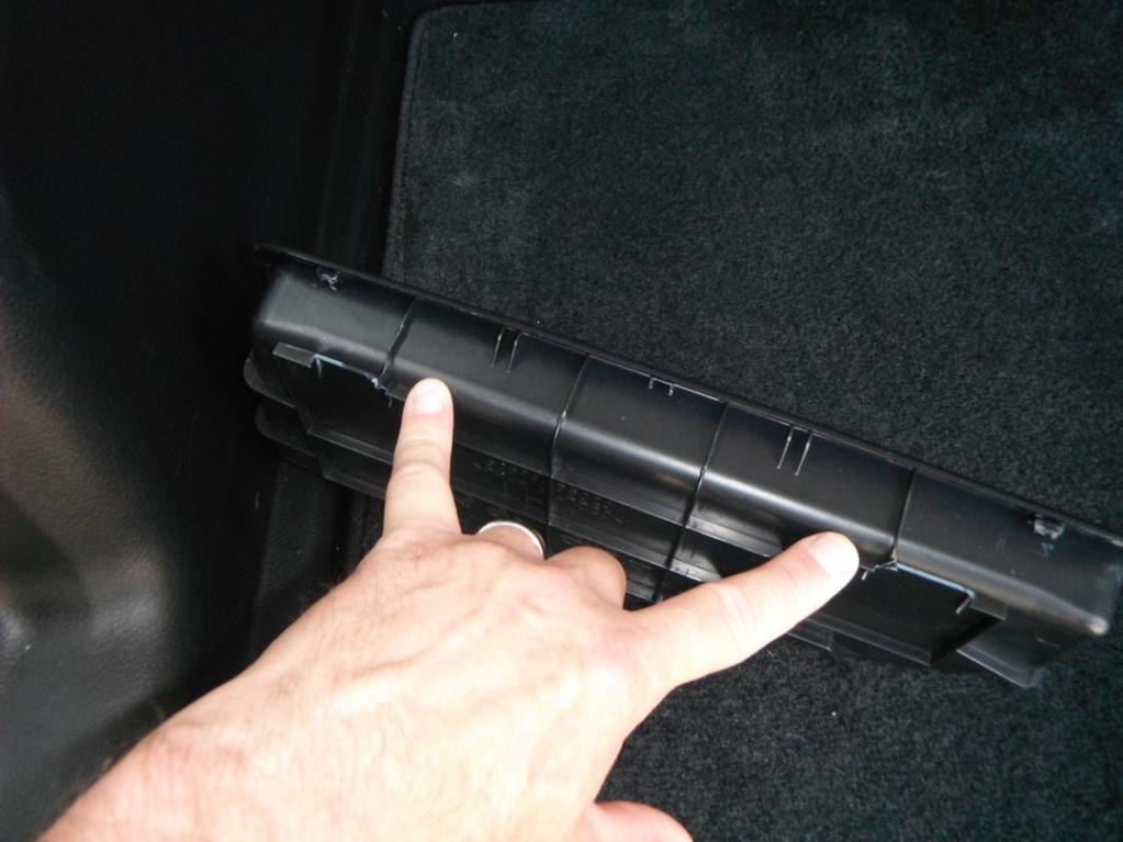

And here's under a lid and the abount of space in the wheelwells. I don't have an A/C outlet nor an amp back there, so I have a pretty good amount of space.
And here's under a lid and the amount of space in the wheelwells. I don't have an A/C outlet nor an amp back there, so I have a pretty good amount of space.
Both sides came off without much effort. Having a Limited there is not much room on the driver side but I'm grateful for every extra square inch of storage.
