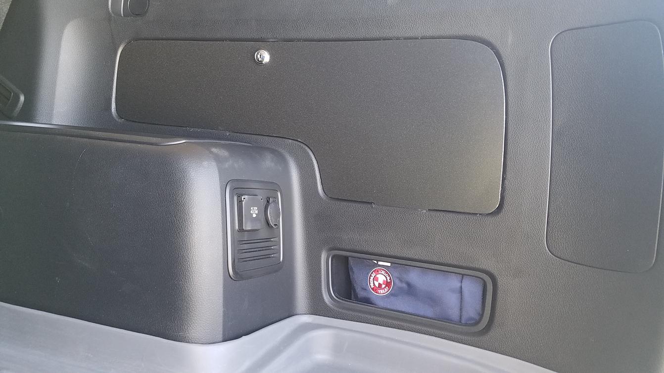

I have a post on it....but basically I made it from a road sign aluminum scrap and a lock off an alarm system box and hit it with plasti-dip!:hello:
