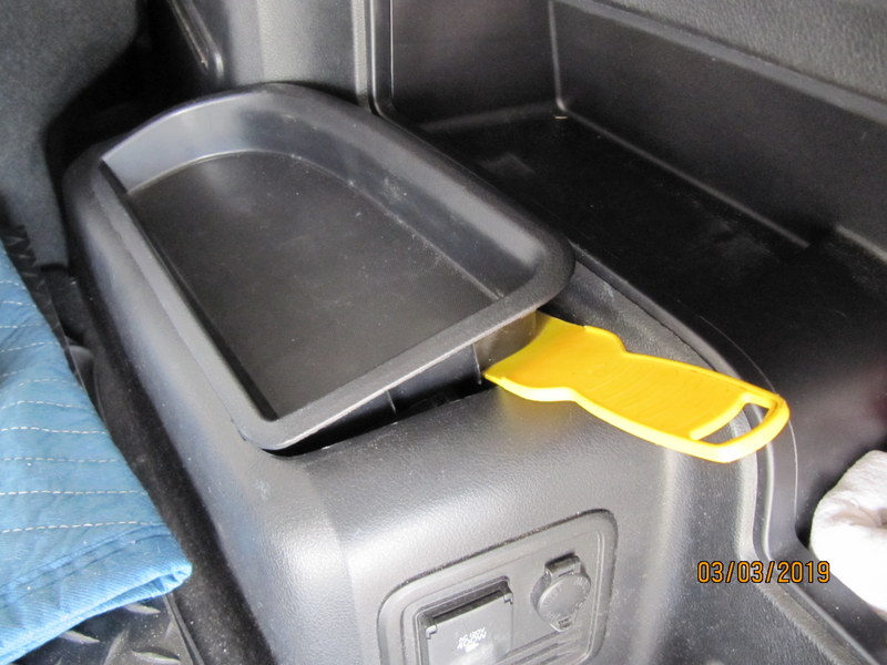

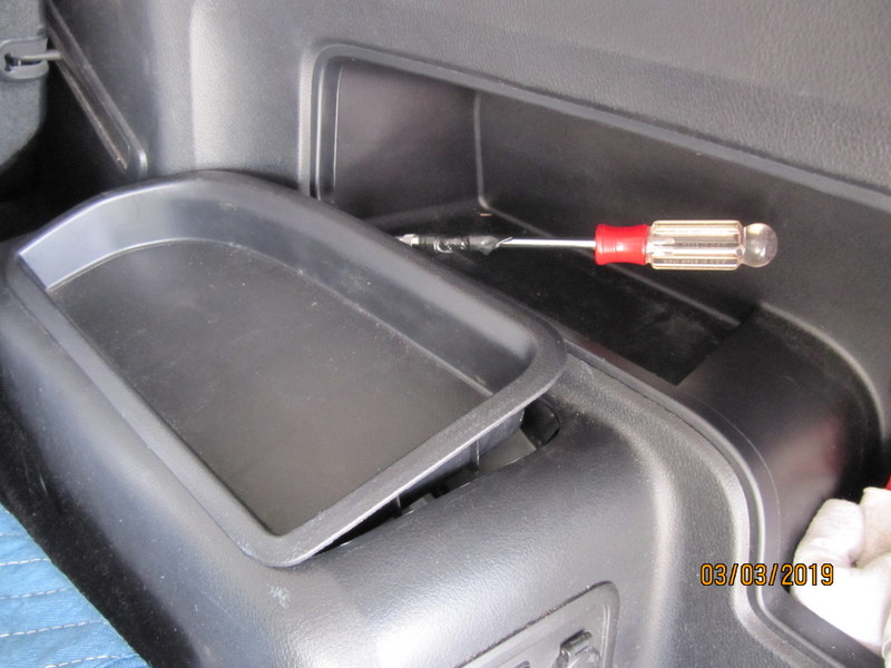

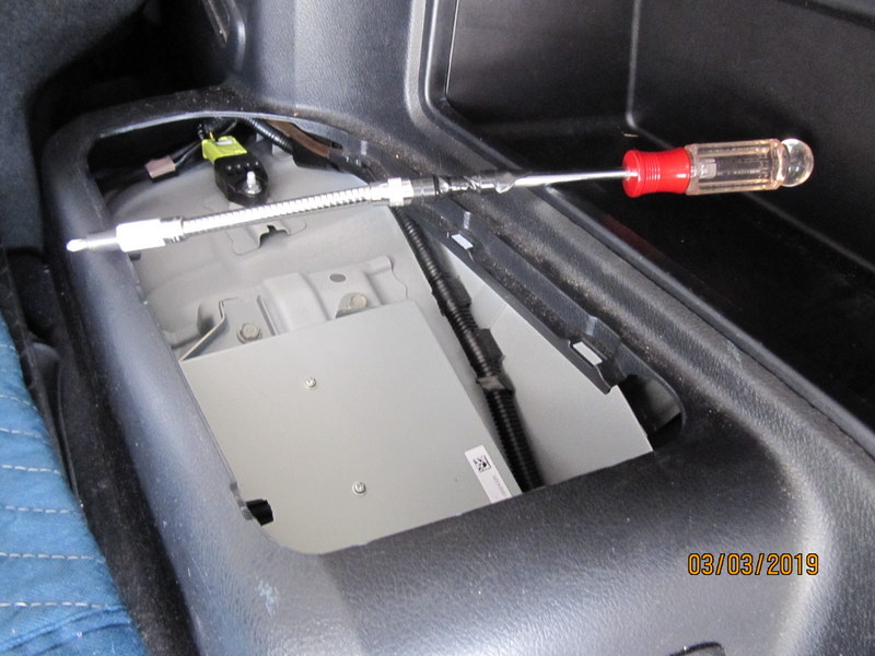

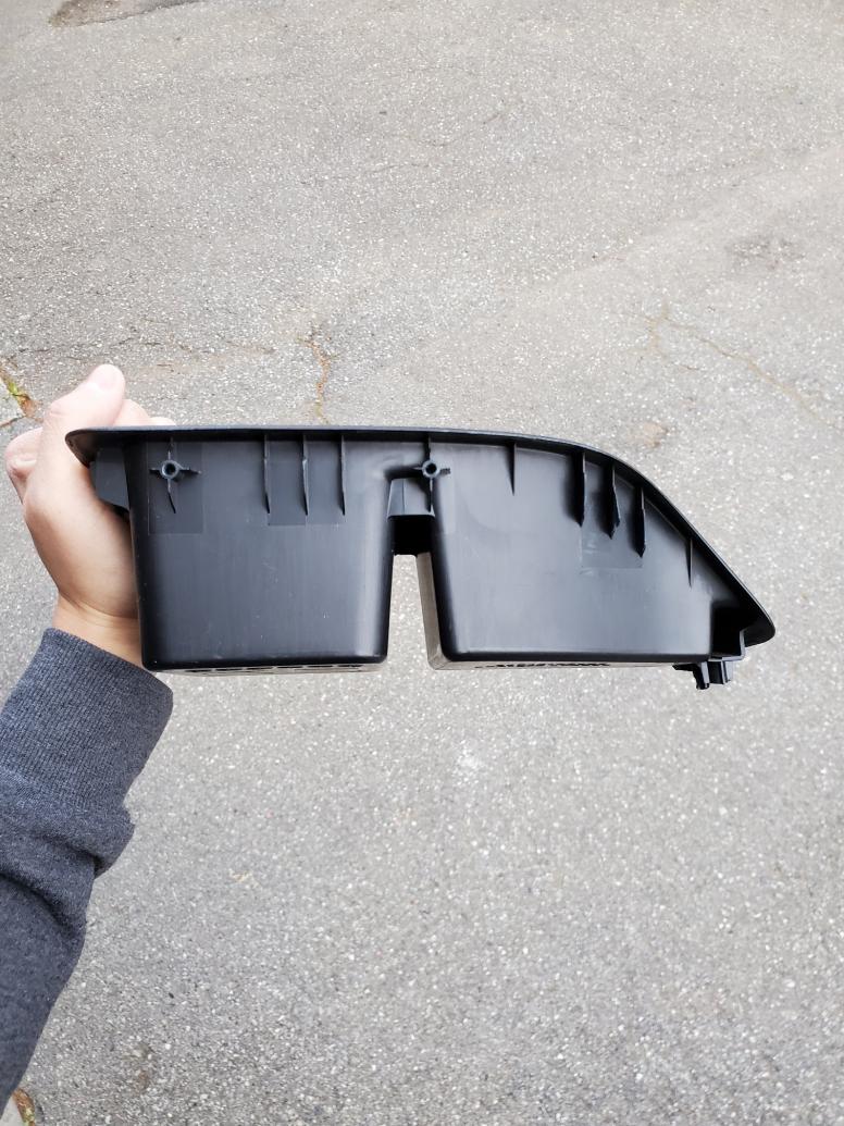

You don't have to break the tabs. I have large hands and here's what I did. I opted to leave the screws out afterwards.
Tools:
Bit driver (looks like a screwdriver but has a place to put a Philip's/torx/slotted/allen/etc. bit in it) $4.99 Harbor Freight
Bit driver flexible extension (has an end that fits in the bit driver and an end that receives the bit, is about 5-6" long, flexes past 90 degrees) $2.99 Harbor Freight and came with 6 bits
Pry tool (I used plastic bicycle tire mount/dismount "spoons") - $2.00/pair at a bike shop
Instructions:
Start with the rear left most corner on the DRIVER'S side "tray box" - pry until it pops a bit. Continue this all the way around the outside (since the 2 screws are on the inner section)
DRIVER's side:
When you can satisfactorily pull it up enough to get your LEFT hand in there, put the flex attachment with a medium-sized philips bit in it in the box WITH your hand inside too and guide it until you feel the bit bite into the screw head. With your LEFT hand still holding the attachment onto the screw head, use your RIGHT hand to turn the screwdriver to unscrew the screw. Do this for both screws.
PASSENGER's side:
Follow all the same instructions for the previous side, except your RIGHT hand goes into the box to hold the bit on the screw and your LEFT hand turns the screwdriver.
I 2nd these instructions. Used a flexible neck on a ratcheting screwdriver with a Phillip’s bit head. Definitely start at he rear as this gives you easier access than the forward one. You can bend to about 30-40* without breaking the tabs. I kept my finger stabilizing the bit head & didn’t loose the screws. I’m going to try a single parador like loop on the center outboard tab & leave the screws out. Eventually I expect to make some kind of inner hinge like that shown above with Velcro. One big point-use something between your hand & the outer edge to protect your hand. It makes it much more comfortable/tolerable.
I saw no purpose for the tabs and screws. I twisted them off then put the tray back on, I can easily pop it open anytime and stick stuff under there. Or when I just need to get to wiring etc
Just wanted to throw in my $.02. You don't have to break the tabs. I have large hands and here's what I did. I opted to leave the screws out afterwards. If the tray boxes become sloppy over time, I'll cross that bridge when I come to it and figure something out.
Tools:
Bit driver (looks like a screwdriver but has a place to put a philips/torx/slotted/allen/etc. bit in it) $4.99 Harbor Freight
Instructions:
DRIVER's side:
PASSENGER's side:
That's all there is to it. No breaking tabs. I'm in Southern California (LA/OC) so if anyone needs help with this let me know.

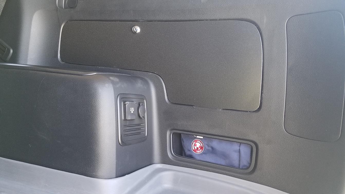

Thanks Trail Truck. I did this today and it worked out great, took about 20 min. most of that was setting up the tools and feeling for the screw head. The flexible screwdriver is the trick and worked great.
It took me longer to find the screw I dropped in the wheel well using mirror and magnet.
My intent is not for storage but to install a couple of 12V- DC outlets and a fuse block that will be fed from my aux Battery. This way I won't have contact with any OEM circuits.
My SR5 has the inverter in this wheel well so space is at a minimum.
Now I can order all the parts to do this mod.

Just saw this post and actually completed a similar install this morning in the same space. I ran the power down the pax side under the door trim panels using 4AWG tied to the aux battery in the pax side engine bay next to firewall (C4 fab battery bracket). I then used the ground from the inverter and tied both the ground and power into a blue sea system fuse box loosely tucked under the panel towards the front of the storage area in front of the inverter. Installed a blue sea system 12v plug lower right corner under the existing 12v plug. I used brute force to break the screw tabs but the top plate attaches no problem.
Tools:
Instructions:
DRIVER's side:
PASSENGER's side:
This is what i did. It scratched up my hands a bit. But not bad. Patience, and persistence. Glad i had the flex attachment. Took me about 15 mins to do. I too left the screws out. It snaps back in tight. I was thinking of breaking off a couple tabs so i can lift the tray in and out easier. Unless someone else has a cool hack that would allow the tray to easily lift off, and yet not rattle loosely around.

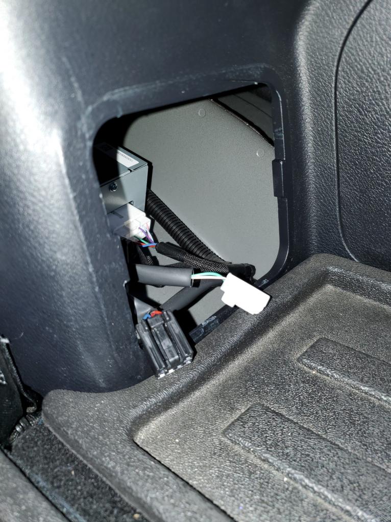

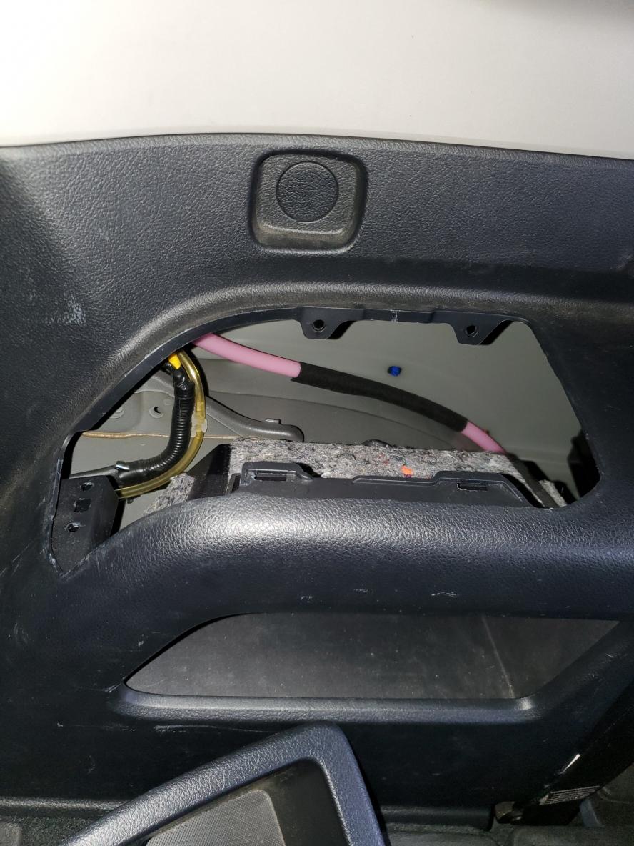

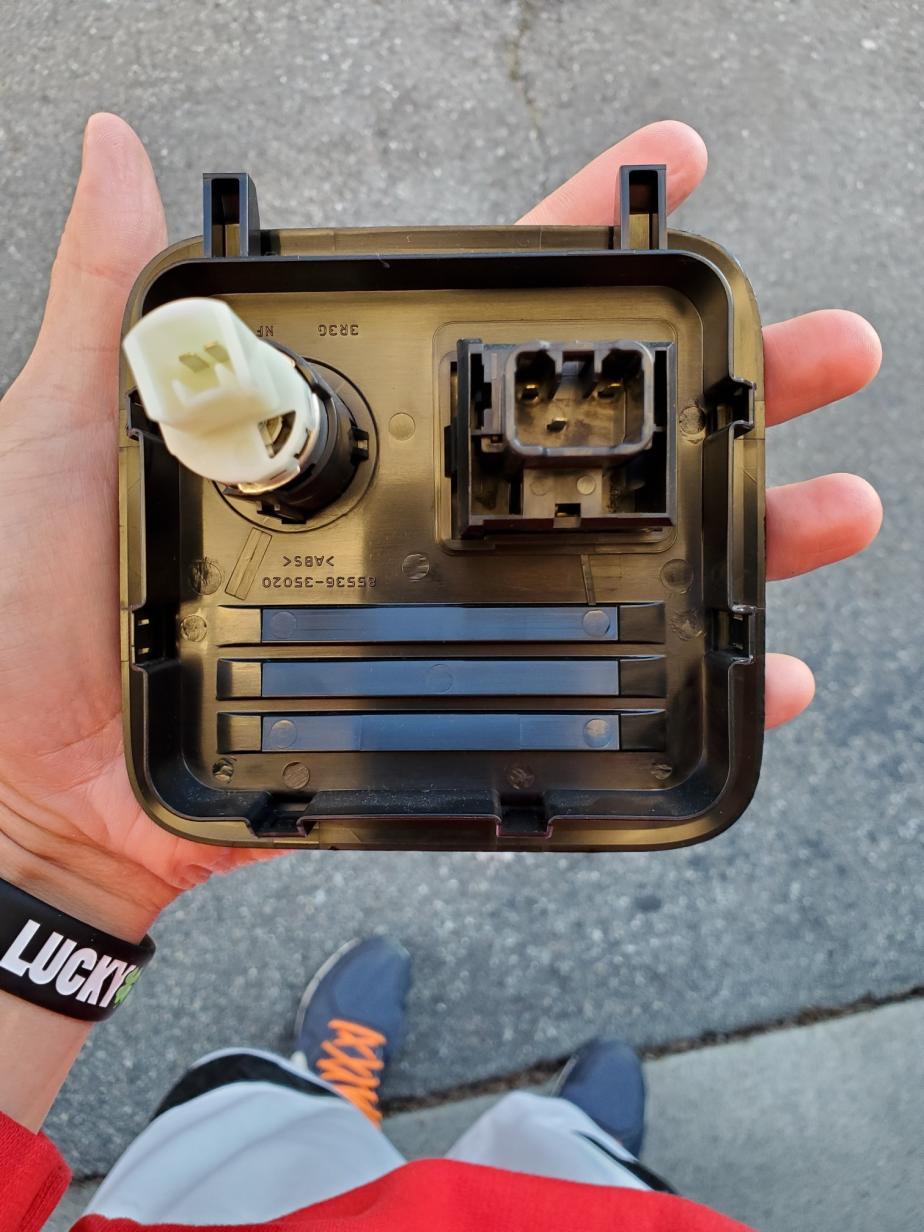

FWIW if you remove the panel with the cigarette lighter, you can put your arm in and reach the screws if you don't want to break anything. I did it with mine (with 3rd row) but should be the same process. Here are some pics done with those with 3rd row seating. In a 3rd row, there are 4 screws.
Here's what the panel with the cig lighter looks like. It just pops off.
