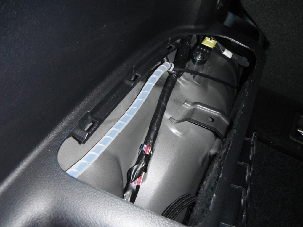

Once again- this was originally Harper7's idea, but here are some pics from my "Brute Force Access" (BFA) method to the storage area :

I have a LTD so my passenger side storage bin is out of the question because of the JBL amp. But do we know what the wires are in this shot?
Im thinking of cramming an air compressor in here and need a 12V constant or 12V acc on to tap into relatively close by.
Hey- that's my truck! The wires that are covered in clear loom are for my CB. The factory loom feeds the back of the vehicle. Taillights, etc. Some of those wires feed the trailer harness, I'm fairly certain. You should have +12V and +12V ignition in there.
And a mighty fine truck it is!
Excellent, I am now going in search of a compressor small enough to cram in there. I also am going to try and track down some wiring diagrams for the 4Runner so I don't have to go probing all day with a multimeter. Thanks for the help!

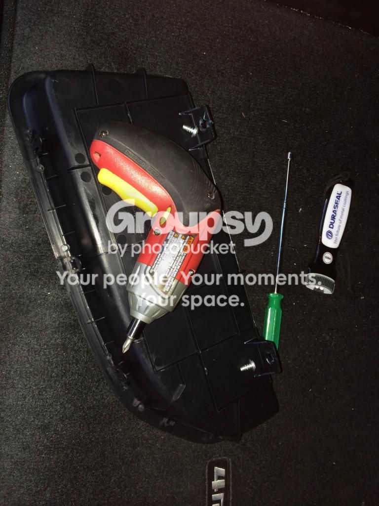

With this small electric screwdriver I was able to pry up the piece and get to the screws and remove it without breaking any of the tabs. Just need a magnet to grab the screws that inevitably fall below. Don't know if it buys you anything but couldn't bring myself to break it off with brute force on a 3 week old truck ;) Stored jumper cables on one side, and bungees on another.

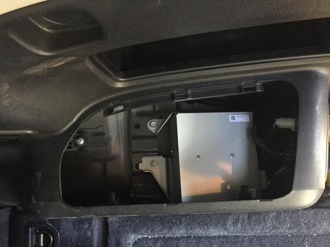

In case anyone is curious, 2013 trail edition, non jbl audio, with dc/ac converter, passenger side. I pulled up the outside lid first and was able to unscrew the tabs, no damage. Snaps back in without screws securely.
