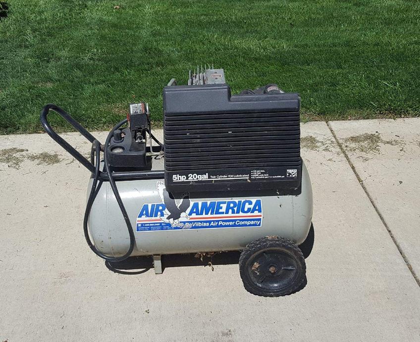

Well this is perfect. I just happened to find a used one locally and bought it! It is Air America, 5hp/20 gallon, 8.7 CFM @ 40PSI, 7.1 @ 90PSI. Most importantly, it came with chisel, orbital sander and wrench w/ heavy duty sockets. All for $100!!
So actually all of your most recent advice still applies. I'll still need to buy all the accessories (maybe just hose and regulator/drier). I'll definitely be going with the hose you recommended and I'll take a look at those fittings if I need any. If you hadn't helped I may have ended up with a real piece of junk.

Here it is:

Nice pickup... I like a good used tool deal.
Just looking at the picture, it appears you might have a regulator built into the unit.
That will probably save you a few bucks too if its in good working order.
One thing to note is that if you have really long line runs, it's better to put the regular closer to the tool than the air compressor.
You don't have to, but it's about pressure drop management. Sometimes it matters, sometimes it doesn't.
