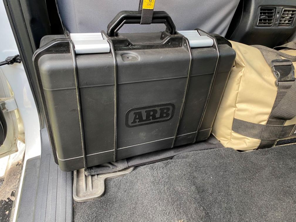

- It's the same compressor, just in a plastic box with the air tank and accessories. The portable 'package' weighs more because of the air tank, but I can put the whole thing where it suits my use better.

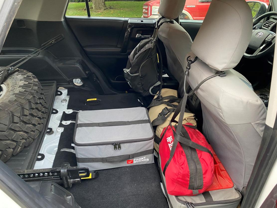

- Good question. My 4Runner is a dedicated wheeler. I don't have rear seats so no legs back there--but plenty of gear space.
(Pic - The portable compressor is under the backpack, behind the driver seat. The Front Runner box in the middle isn't usually there)
