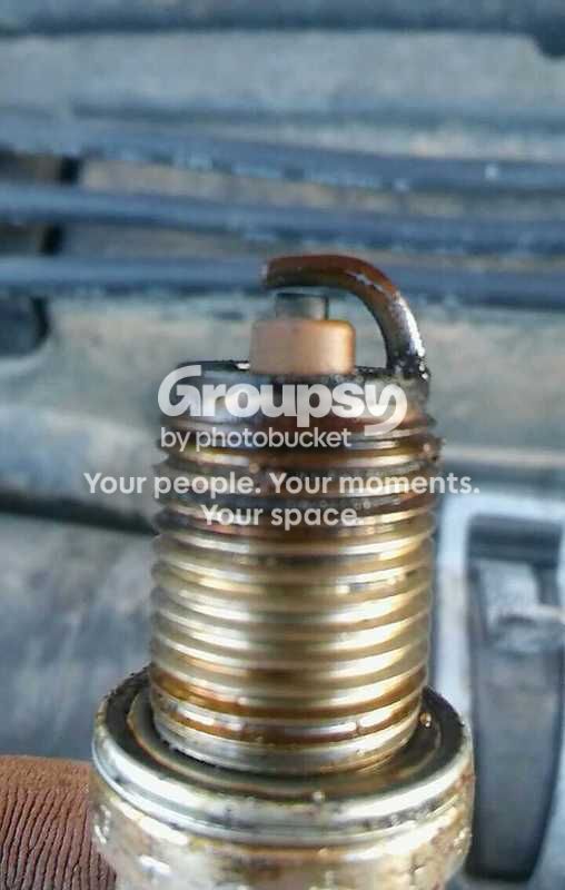

So tracking a missfire i found this ...

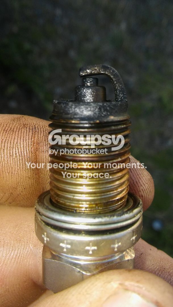

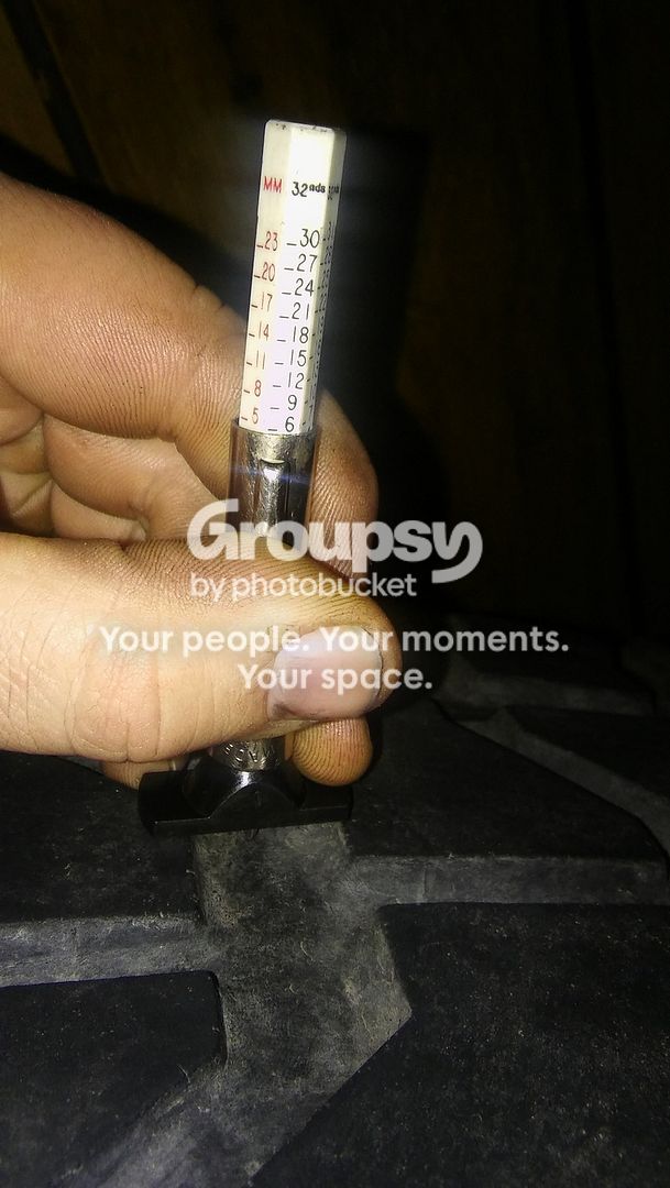

Plug#1
Plug#6

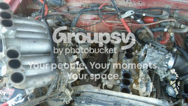

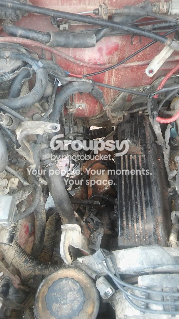

Well i cleaned em . re-gapped em . got rid of the missfire .. But it still ran rough .. Also had a funny sound coming from the back side of the engine . got a tip that it was under the plenum so i removed it ..
This is some of what i found ...

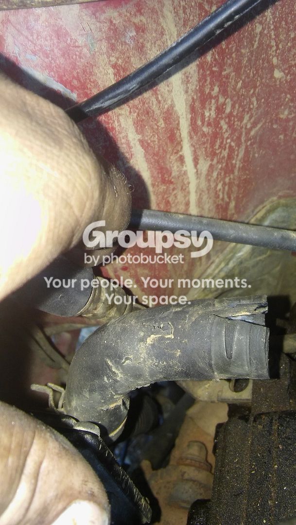

This was cracked and not connected .. Thats also where the weird noise was coming from ..

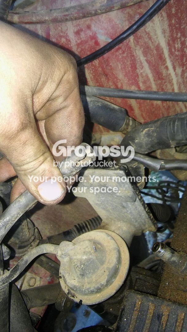

Also this vac line was disconnected and cracked ..
( that hose went to this hard line .. ) cant see it but 2 of those 3 little vac lines also cracked..

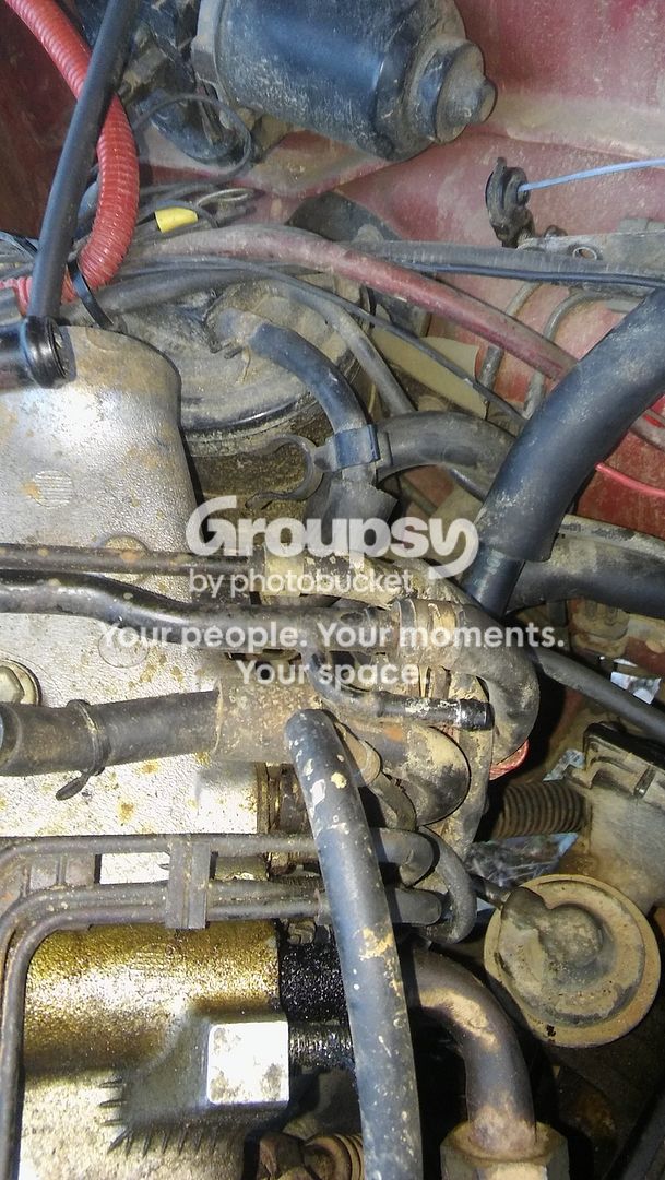

So .. The plan now is egr and pair valve delete .. Ive looked it on a few places still kinda confused on on the pair valve. Any tips or good detailed diagrams are welcomed ...

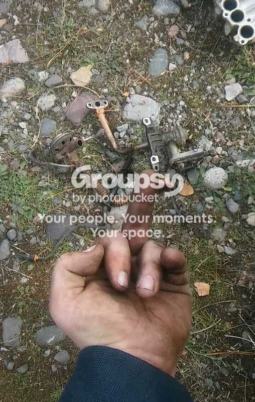

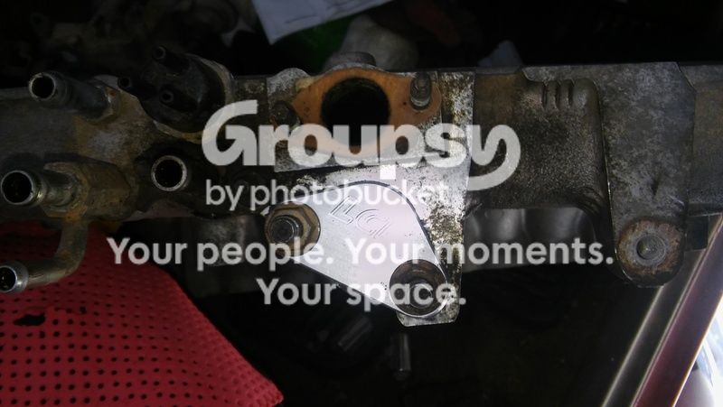

Well didnt do alot but made a little progress .. I got my egr and pair valve removed and all vac line off that ill no longer need ..
So now waiting on plate kit and need to get plugs for the vac lines ..

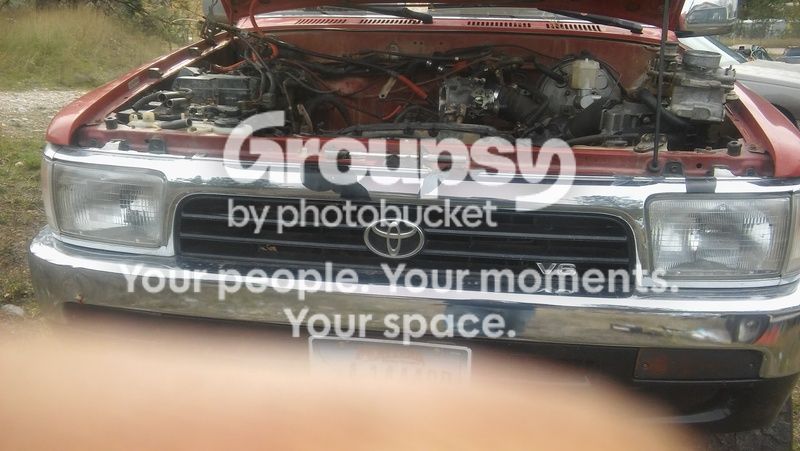

Also the chrome on my grill is peeling .. So i need to decide what to do about this ..

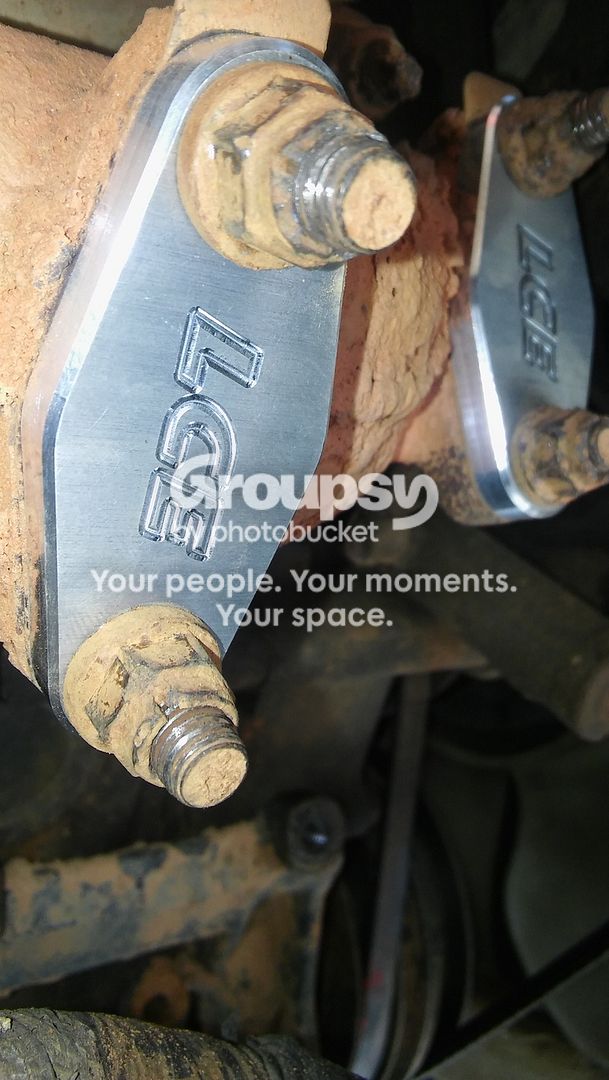

$20 for a EGR block off is a far cry from $7,500 motor. Still too much for a couple of pieces that could be fabbed at home with hand tools, but hardly a rip off.

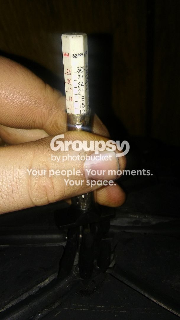

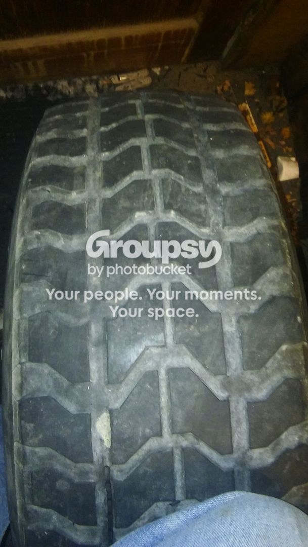

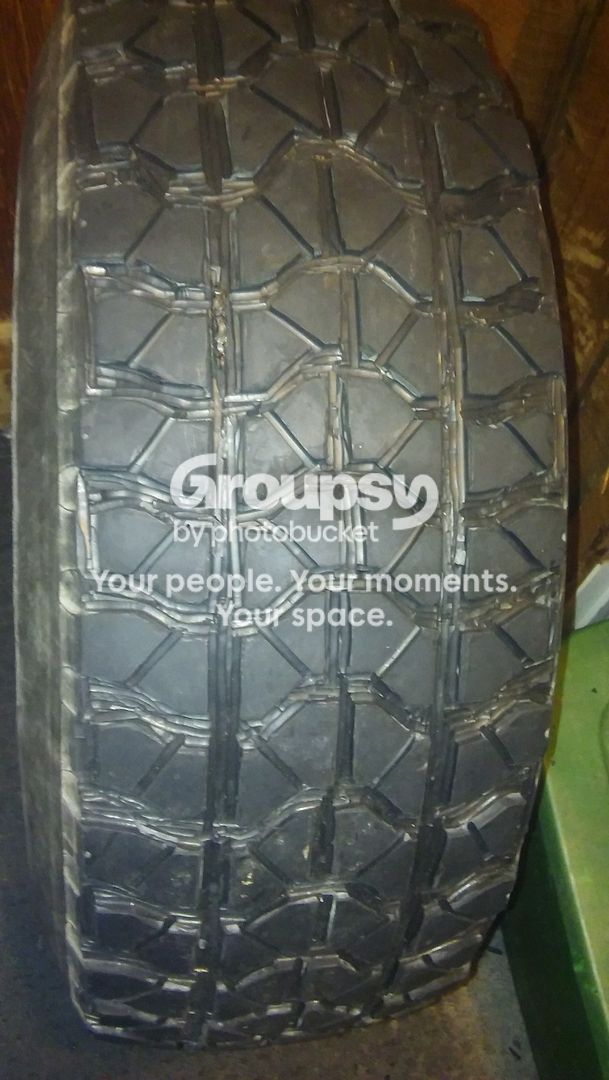

Anyways ... Here is what im doing to my tires ....
Started with this...
Going to this ...
Also have this to install when i find time and a day its not snowing or freezing ... (4runner sets out side .. I dont have a shop) ...

The 37" humvee tires are great pricewise but heavy as crap.
Your groover looks the same as mine, can't beat it for the price. Took me one tire to get it right with out breaking blades. I think 3 on the first tire
Yeah ive had the tires going on 2 years (used of course) got em really cheap .. Rather have iroks but i cant afford em ... I havent broke a blade yet .. I did 1 tire with 1 blade ...
