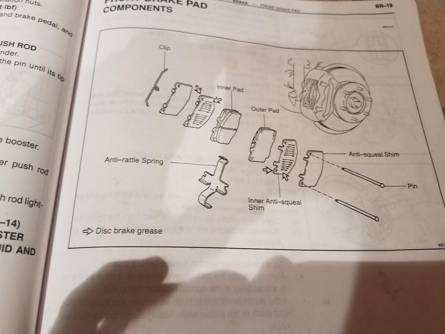

You are correct that the OEM pads come with a grease packet and it's for the shims. You're suppose to spread it on both sides of the slotted anti-squeal shim. People who have gone with aftermarket pads make the mistake of discarding the anti-squeal shims. These shims could be reused for the life of the vehicle provided they don't get destroyed from rust.

Not to difficult. Took a little over 2 hours. One or two comments
1. Yep the factory shims come with grease but don't count on having any left. I bought new shims
2. The outer pads are actually labled Left and Right on the back. I just happened to notice this.
3. Lug nut torque - owners manual says 83 but my Toyota FSM says 76 - went with 83.
Only issue was it took forever to get the top caliper bolt back in the hole on left side. I had the bottom one in and it would not "find" the top hole by pivoting. Spent probably 15 minutes screwing with this issue.
