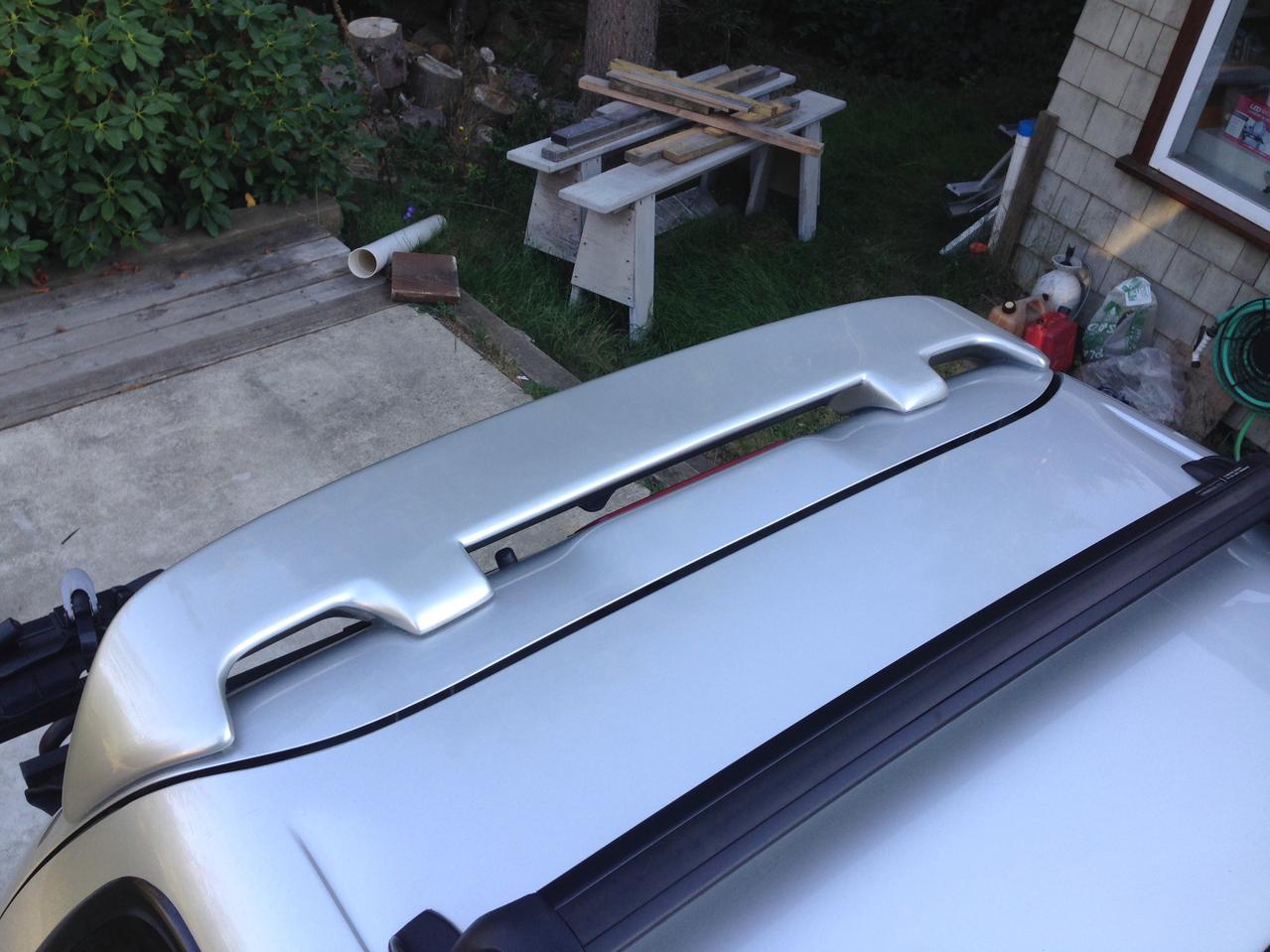

Im another with one of the spoilers...
I reccommend having it painted, hes very good with making sure the finish is top notch before sending it. Perect match for my "millenium silver".
Aswell... I second the "not so easy install" definitely have someone with experience do it if you have any doubts. That rear lift gate has several layers of steel to drill through and angles not easy to tackle/align.
The lens when ordered "clear" will still have LEDs that you can see through it that look clear too but light up red. Personally i decided a red lens so that the install looked stock ( like the spoiler was a factory install and meant to be there)
