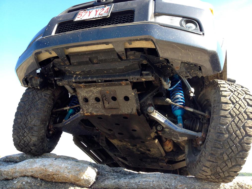

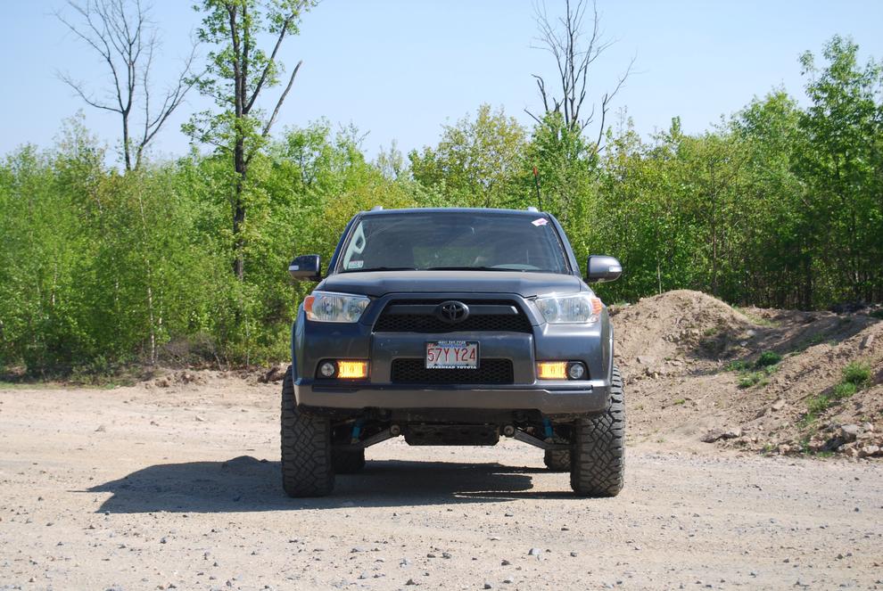

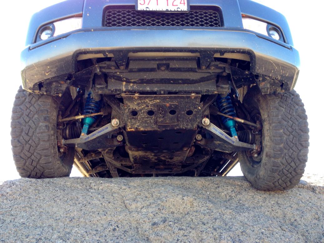

Not an issue here. Increased my track width 4" with my long travel. Go this route if you're worried.

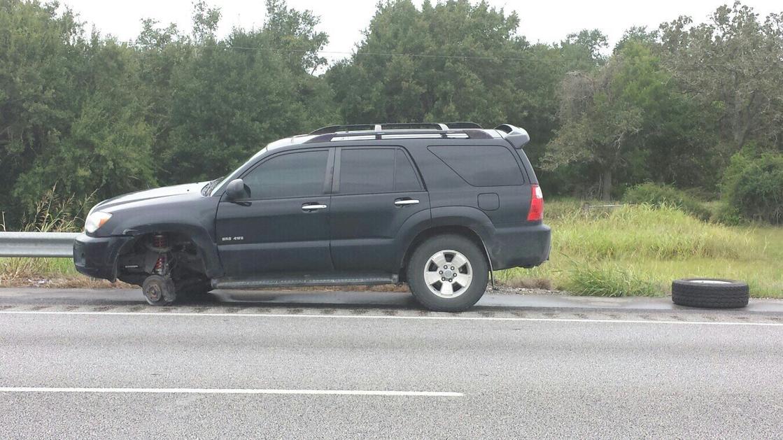

I've personally seen failures on the trail and on the highway. Be careful and recheck your torque regularly! Use a torque wrench and specifically recheck after heavy off-roading, driving on washboard roads, or excessive braking like long down hill runs with a trailer (actually avoid towing altogether with them).
scary vid
http://www.toyota-4runner.org/4th-gen-t4rs/151197-careful-if-you-install-wheel-spacers.html
